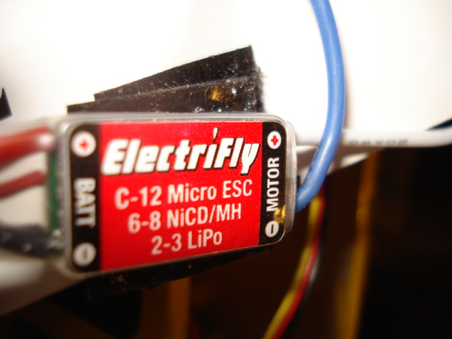

Bruce, I posted on Watts. Yes I understand now. It's just our club lost it's Nitro field and we only have a Electric at the moment. I should join another club but I hate to leave these guys. Could the differents between 12V and 7.2 and 8x6 and 12x6 create enough power to move this plane> I still think theres something wrong with the plane. Could the ESC be wrong, it's for BRUSHED Motor, this Graupner: Speed 400 Motor is Brushed? Right? [&o]
Cloud Ranger 24oz. A “Graupner: Speed 400 Motor , 7.2V Thrust 8Oz. Volts 8.4 Gearbox 2.33:1 Battery: 7.2v 20C 1550mAh using a Electrifly C-12 ESC for Brushed Motors Prop: 8X6, "These are motors that consume from 35 to 75 Watts and about 6 to 10 Amps"

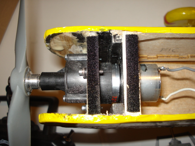

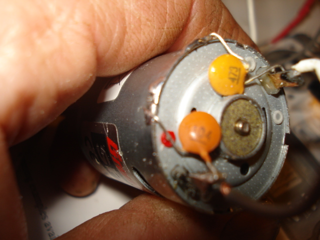

Ok what am I doing wrong here. I have no power at all. Heres the setup. A 24oz. Plane. A “Graupner: Speed 400 Motor , 7.2V Thrust 8Oz. Volts 8.4 Gearbox 2.33:1 Battery: 7.2v 20C 1550mAh using a Electrifly C-12 ESC for Brushed Motors Prop: 8X6, "These are motors that consume from 35 to 75 Watts and about 6 to 10 Amps"
Is this motor just hooked up wrong? I soldered the diodes in place. You know after writing this out, this motor just isn’t big enough is it? Says it will work on a 25Oz plane but I doubt that. I think I need a Speed 500 Motor. I’ll order this one http://www.hobby-lobby.com/speed500.htm what do you guys think? This first electric plane is driving me crazy.
8oz is not a lot of thrust, and is more suitable to a light foamy.
A "25oz" plane is a stretch, it would have to be a lightly loaded trainer that doesn't need a lot of thrust to pull it along.
Usually with gear boxes you end up with large diameter props with high pitches, to compensate for the slow RPM rate produced by the gear box. The offset to this is that because of the gear box, a rather wimpy motor can produce consistent RPM's with the larger prop which equals more power.
What plane are you flying?
Also the pictures help but it would be better to see a pic with the pinion gear showing to show us how the motor is retained.
BTW: There are also drop in "inrunner" motors that produce more power too.

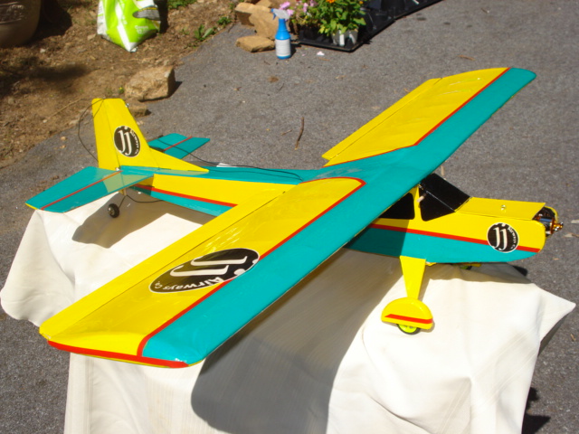

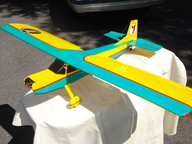

OK, OPJose, lets say I just ditch the whole setup and start over, could you put something together for me using the 7.2v LiPo batteries since I have three of them. First is 10C 7.4V 1800mAh 2cell, next 2 cell 7.4v 1000mAh LiPo mini Battery, and the third 20C 1550mAh 7.4V 2Cell, I also have a 10xAA 1000mAh 10cell. So knowing I want to use them, the Plane is a "Cloud Ranger" by Herr coming in at about 22 to 24 Oz, with about a 10 oz wing load.

[8D]OpJose thank you that site is perfect. Okay for the beginner stupidity. I figured out what was wrong with my whole setup. (drum roll please) The pinion gear was slipping the glue gave out. So I re-glued with CA and activator. took nylon ties and strapped the motor in place. I never like the idea that the motor was just pressed in place. Tomorrow we fly and I will post as to how well. We still might have to change the motor, but lets at least give this configuration a shoot. Thank you all for helping. This is not an easy hobby by any standards. I have never done so many task to complete something. i just balanced the whole load and the battery can not be place where the plans say to, so shoved that up right behind the motor. Still had to add two more oz. Well wish me liuck, the journey may not be over yet. [8D]
