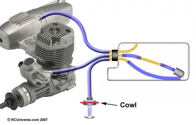

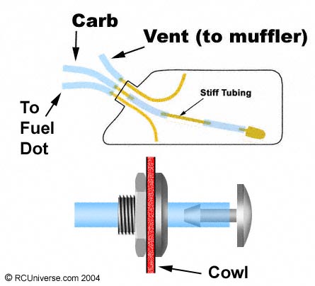

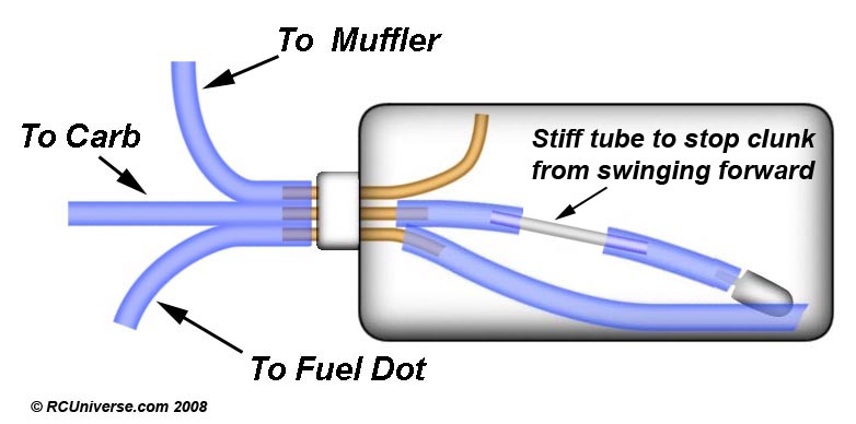

Here's a few diagrams to explain how a 3-line fuel dot system is set up.
Ken

With that system, when you fill, do you need to remove the muffler line to see when the tanks full?
Is what I'd need is a stopper for the tank with three lines, fuel line and a fuel dot to mount on the cowl?

Cappaj1,
You don't necessarily have to remove the muffler line to fill the tank. If the muffler is pointing down you can pump in fuel and when the tank is full the excess will flow out the muffler. It's very important that you do this on a muffler that points downward, otherwise the muffler will fill up with fuel.
For a three line system you need something to close the third fill line. Either a stopper or a fuel dot. On the B-25 review I just finished I used the stoppers that you listed above. Look at the review and you can see how I dealt with them. [link]http://www.rcuniverse.com/magazine/article_display.cfm?article_id=1011[/link] . Presonally, I prefer the fuel dots. They are quick and easy to set up, and foolproof to use.

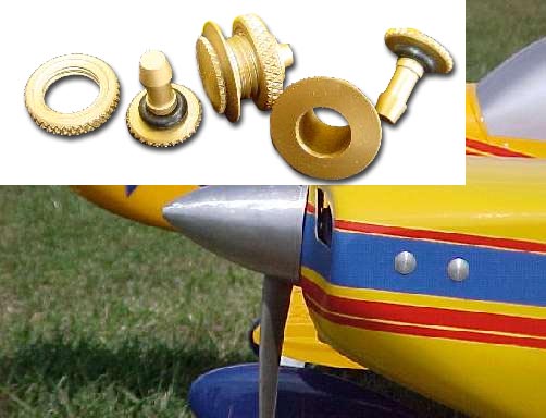

Also, how do these work (see photo of fuel dots below)?
After mounting on the fuselage, do you just pull the plug and insert a tube into the opening?
Is there any leaking while filling or are the connections pretty tight?
Also, any disadvantages to the three line fuel system?
Thanks in advance.

ORIGINAL: cappaj1
Thanks in advance.
1) The tube is run through the sl;eeve and when you pull out the "dot" plug it brings the tube out with it. Dieconnect the plug and connect your fuel fitting adapter.
B) Pretty tight.
iii) Not that I can think of. You should find an unobtrusive spot on a scale model but for sport the sky is the limit. I go one step cheaper and just use a fuel line plug that plugs the end of a fill line that is loose inside the cowl and hangs down beside the end of the vent line (which I also plug for transport in my stationwagon). http://www3.towerhobbies.com/cgi-bin...&I=LXK138&P=ML Two for 95ΒΆ

cap,
the fuel line goes through the main body and the plug goes into the fuel line and then is pushed back into the hole.
see RCkens first picture it shows it well.
