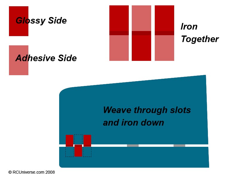

Decathlon came with surfaces pre installed with plastic pin hinges. Rudder was hinged to stab, and installing the stab required epoxying the bottom hinge into the tail of the plane. This hinge broke and needs to be repaired or replaced as the rudder now moves laterally instead of just pivoting. The hinges have a pin (looks like) securing it to both the rudder and stab on pre installed hinges, and pin in rudder but not tail on bottom hinge.

Ok just found out it gets worse; vertical stab is also cracked. Still need to fix that hinge, and will check things over with incidence meter before deciding what to do to stab - not sure if tail will be torn down and rebuilt or not another thing, elevator halves were misaligned, after bending back the one side is not as tight, how do i fix that too?. More to come...

Sounds like a Robart style hinge setup on your airplane. The Robart hinge however has metal pins. Your hinge pin may have failed because of misalignment of the hinge line causing binding and stress on the hinge pins when the rudder was moved.
Is it possible to replace just the hinge pin itself with a metal replacement? Could maybe be made out of a straight pin or T-pin material depending upon the diameter needed. If the old hinge pin can be removed its probably the less problematic way to go.
Otherwise you've got to remove the rudder, and if you have to go that far I'd replace all the hinges with a better ones. Epoxy breaks down around 300-325 degrees F so its going to be tedious task removing the old hinges. Depending upon how much room you have you may want to cut the hinges off flush and cover over them. Then install new hinges next to the old hinge positions.

Thanks Steve. On the rudder, the plastic broke, not the metal pin.

Just cut the hinge and rehinge next to it. You have to repair the verticle stab anyway.

Just make some hinges from strips of covering and slip them through the slot - no rudder removal necessary

Make sure you won't need the remove the rudder to fix the vertical stab. It would suck to fix the rudder only to need to remove it a few days later. If you need to remove those hinges the best way is to use a Dremel cutting wheel and cut them in half. Then sand them flush to the surface and mount another right next to the old one.

Great, thanks guys. Won't know about stab until I figure out what's up with the incidence (see related thread).
