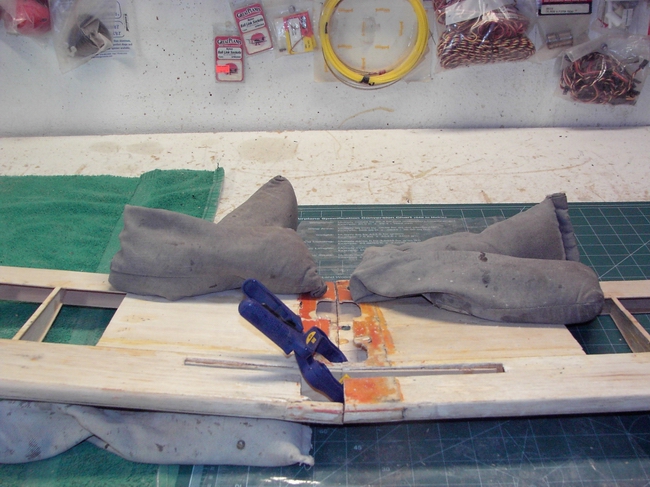

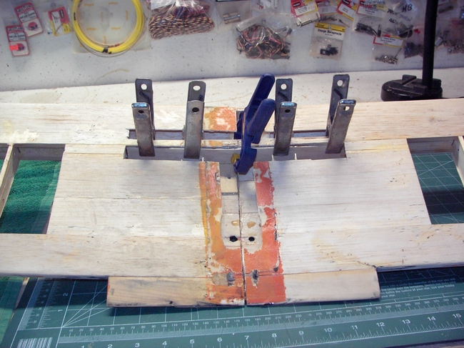

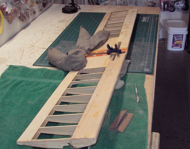

Here I beleve is whats being described. Its a wing I deliberately cut in two to change some angles with a ply doubler being installed over the abandoned original and the rib filled in agine up to the new doubler.
John

Just cut it off flush . Cut away the sheeting top and bottom, front and behind, near the spar.
Cut the slots into the center ribs for the jointer.
Glue different joints to the front and back of the spar. Use clothe line clips to clamp the jointers to the spar.
Sand the new jointers flash
Alter the diehedral if you want to. Just use tri stock (center ribs to jointers ) after re angling the center ribs accordingly
Then just resheet.
I'd cut all the sheeting and re-sheet like Campgem said becuase I hate sanding fiber glass. Plus I think it's just easier and
the final finish will also look much better. Plus I'd add another jointer to the rear spar just for kicks.
Cut the center Alignment tab. Install a center piece dowl.

If you buy a wing set, you are going to have to put the sides together anyway, so scratch that out of your list of problems. Your only problem is getting a space to glue the new jointer into next to the old one. And, a bit of covering to finish things up.
Tools you will need to cut the wing in half at the joint. A hack saw and a razor saw. On the damaged side of the joint, mark a line 1/8" away from the glue joint between the wings, toward the bad side. Use your razor saw and saw through this line all the way around the wing. You will cut through the surface sheeting and the you will need to use the hack saw to cut through the spars and lE and TE, and the diherral brace.
Once you have the halfs seperated, use some carpet tape, and tape a full sheet of sand paper to a flat board. Position the wing about to the dihedral angle for a half wing, and sand the cuts flat. Stroke the wing across the sandpaper only one way to keep it straight. If you push pull, you end up with a high spot in the center. Do the same for the other half. You should now have two half that are ready to join. At this point, you can open the bottom and make a new slot for the dhideral brace. Glue things together and then close the opening with new balsa, I would get 3/32" for this. Sand things smooth and then, you can seal down some new covering over your repair.
I doubt that your wings were joined with fiberglass tape, so just ignore that part of the previous instructions. You can use clear heavy packing tape as a good fuel barriar and then pickup some Kylron FUsion plastic paint from your ace hardware store, that is a close match to your covering, and give the tape a couple light coats.
The only issue I see that you may run into is that your wing hold down dowels and screws my end up a little two wide by 3/32" inch. This won't be a problem with the screws, just use some sand paper glued to a wood dowel and sand the holes in the wings to the joint. You will only need to go about 3/64" on each side. For the dowels, I would do the same thing, but on the fuselage former and this time sand them out the same amount. THe reason for doing this is you are going to end up with a wing that is 3 /32" longer and that extra length is in the middle.
Total tools you will need. A Razor Saw, A hack Saw, and Xacto Knife, and some sand paper. Materials, a 3/32" sheet of balsa, A new dihedral brace, some clear packing tape and a can of Fusion spray paint. $10 to $15 bucks top for everything.
