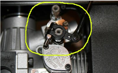

My rear exhaust Rossi .61 has a remote in flight mixture control that rotates the entire needle assembly about 20 degrees as a secondary to the primary needle adjustment. It is simply operated by servo and pushrod to its actuating arm. I find it unnecessary and it's just tightened off.
Well, no more than is neccessary for a throttle but that would also depend on the design of whatever the heck it is we are talking about. However I have a feeling you are talking about some use that is no relation to what any thing we know and therefore questions like that are impossible to answer These type of guessing games when you won,t explain exactly what the function desired is and other parameters are really just moot.

well...there's a hole at the tip of most needle valves, Most people mount an extension to it.
what if you mount a rod with threads so you can thread a thing of ma roo with an ear so you
can hook a cleves to the ear.
You know....the think of ma roo..like the ones on the rods for the airlerons if you mount the wing at center of the wing.
If you have access to a machine shop...just make a disc with a stud.
A sileniod to activate the servo..not sure what your set up is.
use air or electric to activate the sileniod.
