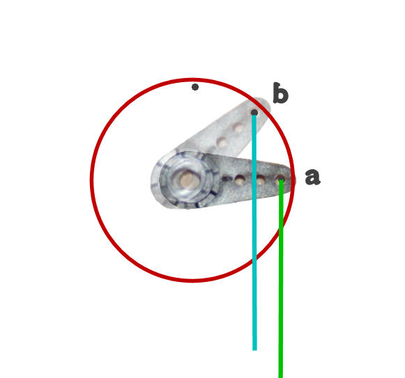

I just got some used JR servos (so no manual) and they came with regular-looking 4 pointed star servo horns, and some other 'off centered' looking servo horns. I'm familiar with Futaba's off-set horns, is that what these are supposed to be? There's no marking on the horn like Futaba has. What's the idea here?

Actually, you want the line from the servo screw to the pushrod connection to make a right angle with the pushrod. The line from the screw to the holes can make any angle at all to the servo when the servo is centered. The important angle is the one made with the pushrod. It needs to be 90degrees.
The 1st attachment shows one of JR's normal servo arms in the upper left.
The 2nd attachment shows a green pushrod connected at a 90degree angle to a servo arm (at location "a" in the picture). As long as you have that right angle connection from the pushrod to the servo when the servo is centered, it doesn't make any difference at all which way the servo is oriented.

Not always the case. You may want differential on the ailerons, so you would not set the servo arm at 90 degrees to the pushrod. Some airplanes need differential on the elevator to size the loops (inside and outside) the same.
So the answer? It depends.

Actually, you want the line from the servo screw to the pushrod connection to make a right angle with the pushrod, if you wish the pushrod to be moved equally in both directions. The connection at "a" does that.
If you need differential movement, placing the servo arm so it is at an angle to the pushrod (as with the configuration as at "b" ) when the servo is centered will give a shorter pushrod movement in one direction. In the picture, for setup "b", when the servo rotates it's arm counterclockwise, the pushrod is moved far less in a straight line than when the servo moves it's arm clockwise. The straight line movement of the pushrod is what the aileron/elevator surface sees. And in the "b" setup, it sees shorter movement when the servo pulls the rod than when the servo pushes the rod toward the aileron/elevator.
Almost always, we want our pushrods to move equally when pushing as when pulling. And to do that, the angle should be 90 degrees at both the servo and the other end of the pushrod. Either end, if it's not 90 degrees, the surface won't move equally.
