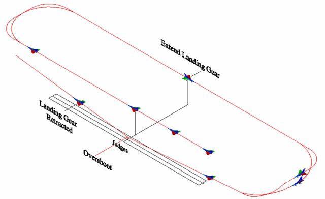

I am not sure what the overshoot is. Is there a site somewhere that I can reveiw these manuvers? I think I know what the 1/2 cuban 8 is. But am not sure. I think you go into a 45 degree climb roll inverted pull up elevator to complete a half loop????

I downloaded information from the Jet Masters as I plan to enter in 2011
from the information
Overshoot
The model shall commence upwind and execute a circuit and landing approach in the
manner of the prototype, descending smoothly at reduced power and speed and, in
front of the judges at a height of approx. 3 metres, aborts the landing and applies full
power. The model climbs on a constant track, heading and climb angle for approx. 5
seconds, during which time the landing gear is retracted. Retractable undercarriage
(where fitted) is to be extended during the downwind leg of the circuit, and flaps,
spoilers, speed brakes etc., are to be extended as per the full-size prototype. (all
types)
Overshoot
types)

ORIGINAL: traski
OK its easy but I dont have retracts. Its a fun fly day so I guess I just have to fly by.
Where did you find that drawing/attachment?
if you have a email address I will sent you the Jet Master information ... or you can download from http://www.ijmc.net/public_html/enter.htm

ORIGINAL: LokiDog
Where did you get the drawing of the overshoot?
Mate goto this site http://www.ijmc.net/public_html/enter.htm
Click on F4J Rules on the Left hand side
then click on IJMC Scale Flight Manoeuvres (January 2007) : PDF File
and you will have all the Manoeuvres[sm=shades_smile.gif]
