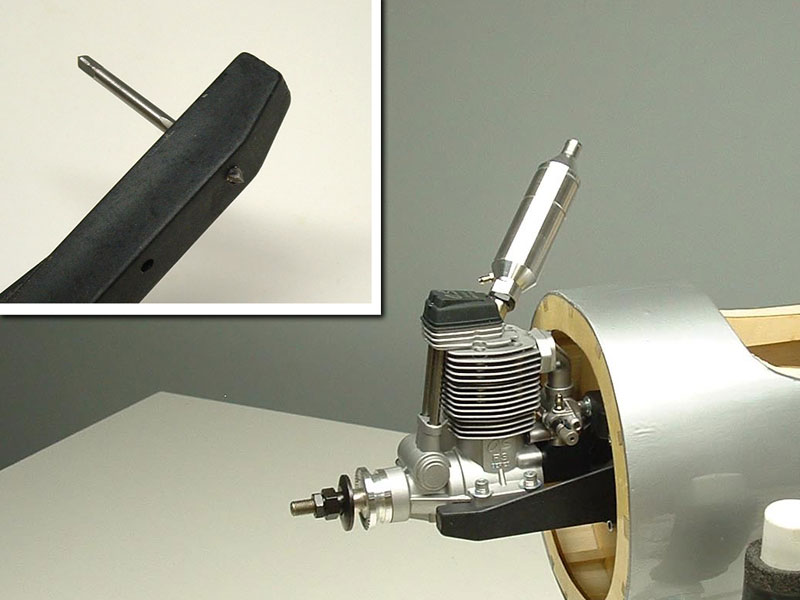

Machine screws into a plastic mount is a waste of time,
Not true! I do it all the time.
If you're concerned about it, just don't tap the hole all the way through - then the mount acts like a locknut.

That picture wouldn't happen to be a new Top-Flite T-6 ARF would it?
As for threading the plastic mount, I was always skeptical but I've done it several times and it holds up surprisingly well. I think the trick is to use the correct size drill bit for the particular thread you want to cut and to make sure the hole is straight and round. I have larger 2 and 4 strokes in GP mounts with threads cut in them and so far, so good. The material on those mounts seems to work very well for the purpose; I wonder if other types of plastic might not work as well?

ORIGINAL: ChuckW
Boy, you've got a good eye Chuck! Yes, it's the new TF AT-6. I am in the process of doing a review of it. It's now finished and ready to fly, but our weather has just turned to crap! I'm hoping we'll get a break soon so I can shoot the video before the REAL winter hits!
