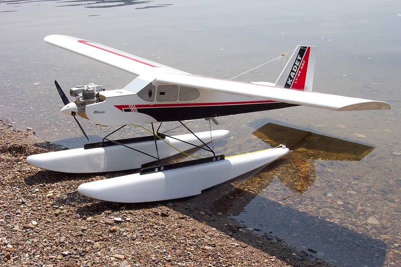

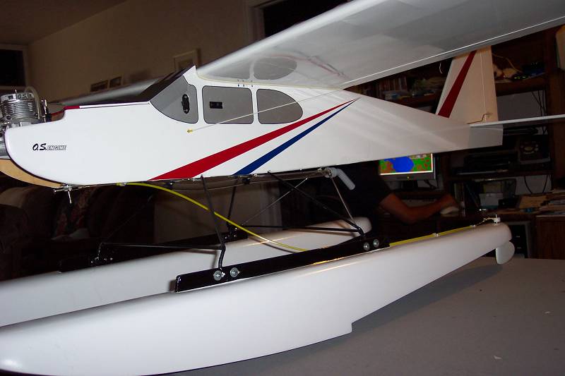

skippyspad's Avatar
Joined: Nov 2008
Posts: 105
From: Loveland, CO
Default RE: Water Float question?
Correct. The step should be just a hair in front of the CG. Also you should have the float at about 1 deg. down from the horizontal stab incident. I fly my kadet 40 on snow and water. Dont forget to take off the rudder for the snow.

Old 12-18-2008 | 08:17 PM
Joined: Nov 2008
Posts: 296
From: Mokena, IL
Skip thank you for the photos, that really helped me out, I also really like the idea of what you did, how you put fuel line from the exhaust and ran it to the side of the plane to minimize extra fuel all over your plane, VERY good idea, I am going to do that to my alpha 40 as I gets sprayed the hell out of and I am always cleaning it everyday with alcahol and a rag. Also I would assume from the set up that you will not be able to turn on the ground with floats on the snow since I am taking off the rudder, correct?
Old 12-18-2008 | 08:36 PM
skippyspad's Avatar
Joined: Nov 2008
Posts: 105
From: Loveland, CO
You get a little turn out of the Vertical Stab, but not enough to taxi much. The rudder will dig into the snow if you leave it on. You won't be able to get the speed to get off the snow. The tubing is vinyl tubing from Home Depot. No sharp corners or it will kink and mess with the engine performance.
