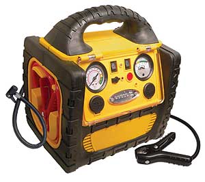

Lastly, I'm currently using one of these for my limited charging.. 18Ah battery, air compressor, 12v outlets, 400 watt inverter, LED lights and car jump start. It will also be my air compressor for retracts...
