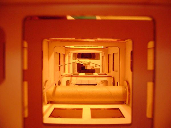

Hi thanks for the info. What is the way to Reinforce the landing gear. Just started working with rc planes this is all new. Been building off of post that other RCU users posted to help. So far thay have worked out great. This site has alot of great help.
Gary
It is a Seagull. The manual for this plane just states to use standard servo… Form the post and reviews I have read on this site this plane is a little different. The wing area on the plane in the review is 768.00 sq. inches and the one I have is 662.8 both planes have the same wing span and same weight. Would like to setup this plane the best I can. I found this plane at Hobby Hanger in VA just outside of WDC it has a little covering damage nothing that can be fixed. They give me a great price, cheaper then I can buy any were else + no shipping. I travel from city to city for the company I work for, nothing to do but play on the internet when in motels. So this is the time I use to find info I’m looking for, like learning, it’s my 2nd hobby, building models is my first. Would like to learn how to select the proper equipment without guessing.
Thanks for your quick reply and help.

The crude drawing below is as if you were looking inside the plane where the landing gear bolts come through the landing gear block. I had to completeley replace mine as it ripped out and snapped in half after a reletively light pancake landing. The red rectangles represent 1/4 inch balsa stock that I epoxied (do not use CA here) in place. I then used an epoxy brush and liberaly painted all the corners and joints being careful not to epoxy my landing gear bolts Hope this helps.

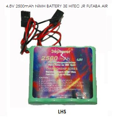

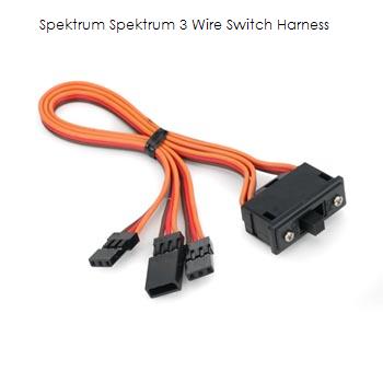

Hi post 1 shows the componets that will be installed in my plane. Please tell me what you think.

Firstly if I don't mention it here I would use the same thing or compairable... and keep in mind my situation may be different than yours. For example I take my Pheonix Extra 300s to the feild completely assembled in a Ford Expedition. If you are putting this in a Mini Cooper you may not have that option.
Switch: Consider an [link=http://www.horizonhobby.com/Products/Default.aspx?ProdID=JRPA004]MPI type[/link] switch that allows you to charge the plane without removing the canopy.
Battery: 2500 Mah is a lot for this plane but digital servos use more power. Ensure you have a charger that can handle it in a reasonable amount of time. 1500 ish Mah is plenty if you go to a good analog ball bearing servo.
