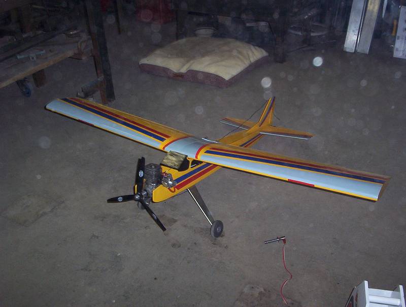

I hope you guys and gals can help, and mods if this is in the wrong place please move.
I Bought a trainer with GMS 47. I have tried everything to make it run, well I can get it to run but only for a couple of seconds before it dies. It is new and when I recevied it the mixture screws were wound right out.
I have set them to the inital settings as advised in the manual and played from there. I have changed the glow plug, inspected the o-rings around the carby. It seams to have good compression.
I have run out of ideas and would be grateful for any help you guys can give.
Regards,
Jason.

It sounds like the previous owner had the same experience and continued backing out the needles in the assumption that they were initially set overly lean.
If you have the model with the remote needle valve assembly, you should check the line from the needle to the carburetor for air bubbles. You should also consider taking the fuel tank and fuel lines out and inspecting the whole system. Many "engine problems" turn out to be tank or plumbing issues such as problems with the clunk line or a vent tube flush against the top of the fuel tank.
If the fuel setup looks OK and you're still stumped, find a flying buddy who is good with engines to help you go through the thing. Remove the carburetor and mount it again assuring pressure on the o-ring to prevent air leaks. Go around the cylinder head and back plate looking for loose bolts. Take a clean piece of fuel tubing and blow through the needle valve assembly to assure that nothing is blocking the flow of fuel into the carburetor and that the needles are passing air (and therefore fuel) when you blow into the tube.
The good news is that the GMS .47 is a terrific sport engine that is very powerful and transitions super fast when set up and tuned properly. If you work to get everything checked out and operating properly, you'll be rewarded with a powerful, reliable engine.
Good luck!

If the engine is indeed new i would probably take it off the plane and set it up on a pc of wood and do some bench running first, maybe spend the extra $5 and get a new tank for your bench running, this way if it runs fine on the bench then you know your problem lies in the tank installed on the plane. All new engines should be broken in first anyways, plus this will give you some experience with the engine before trying to fly a plane with it.
Yup as Bigedmustafa said, start by assuming that the whole fuel setup is bad or clogged.
That your engine runs for a few seconds tends to point to the carb, head, glow plug, etc. being OK, although your mixture may still not be correct.
An engine quitting after a few seconds can also be caused by insufficient tank pressurization....
Anyway, as he said, pull ALL of the tubing out along with the fuel tank.
Using a clean piece of tubing, hook one end to the High Speed needle inlet nipple and blow in the other end while moving the throttle control.
At full throttle you should be able to get a HISS out of the carb body as you blow.
Then check to see that the tubing and piping into and out of the fuel tank permit free flow in either direction.
Finally clean out the muffler pressure nipple. It may be clogged.

Thanks for all of your advice. I pulled it off the plane, built an engine stand for it, pulled the tank and lines out of the plane. Made it easy to set up and in no time at all she was running sweet. Have put most of a tank through it now with no problems.
Thank you all again.

Well guys, I put everything back into the plane. I prime it up and when I am ready to start it the fuel runs back into the tank. Would I be correct in the assumption that the tank is too low in the plane. The plane is an Explorer 40 ARF and if I am correct then it either requires some surgery on the plane, or I would have to invert the engine and change the throttle linkage.
I did get it running in the plane with a mate holding it slightly nose down, once running it was fine due to the pressure from the exhaust in the tank (I guess).
Anyone else have this trainer and if so any ideas?

It is possible that the tank is a little low, you could have a small air leak, will it run back if the throttle is fully closed? As long as you get it running and it keeps going you'll be fine though. How much lead did you need to add to the nose to get that plane to balance?, i know my explorer .40 had a 32oz 21cc weedeater engine on it and the CG came out perfect.

Yeah, checked for air leaks, I have changed the position of the high speed needle which brings the fuel line lower in relation to the tank. It seems to be better. Thanks guys.
