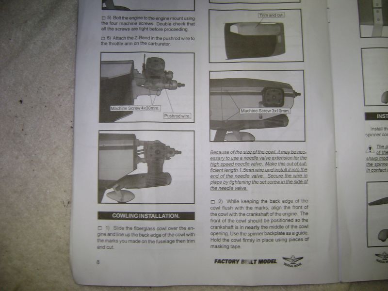

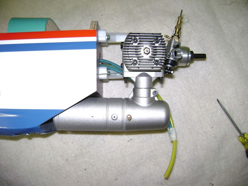

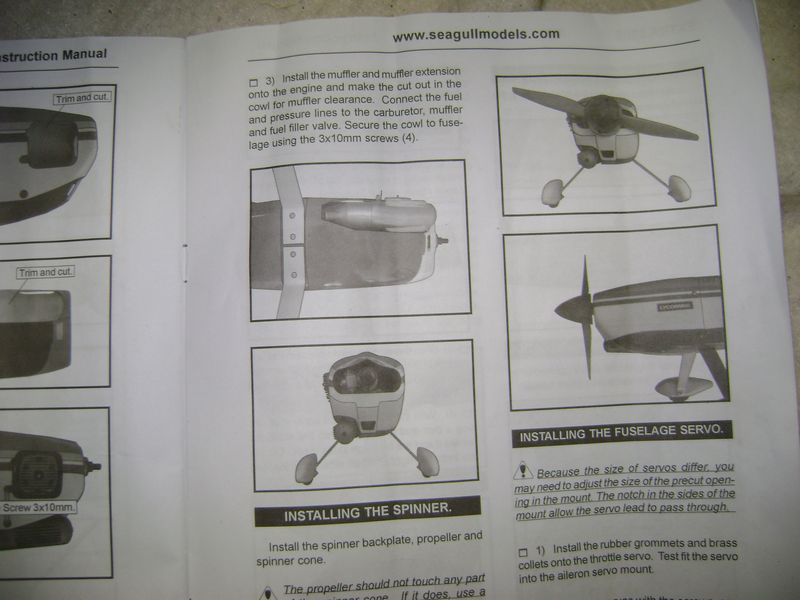

Hi. Here are some pictures of the problem I have. Installing a SuperTiger G90, the muffler doe's not extend past the bottom of the plane, would like to use this muffler so the question is Can I pass the exhaust throw the plane? If so, what type of material do I need to extend the tail pipe and do I need to heat protect the wood?

There is a couple ways to do this. There is the easy way and a hard way. The easy one is to redrill new holes and turn the motor about 25 degrees. It will put the pipe out the cowling. Im not a super tirge man. So the hard way would be for me to tell you what parts for you buy. If you redrill hole find some wood to expoy in the old holes. Its not as hard as it sounds. it might take a hour or two to redo .

I've got the g75 and had the g 90 on my seagull yak. The only bad thing I can say about them< their mufflers suck!!! It took a large cutout on the bottom(mounted mine sideways) of the cowl, long cutout i guess and a deflector and was good to go, minus the 1/3 of the muffler hangin out the cowl. I just ended up gettin the bisson pitts muffler and it was just 2 little stacks out the bottom after words.

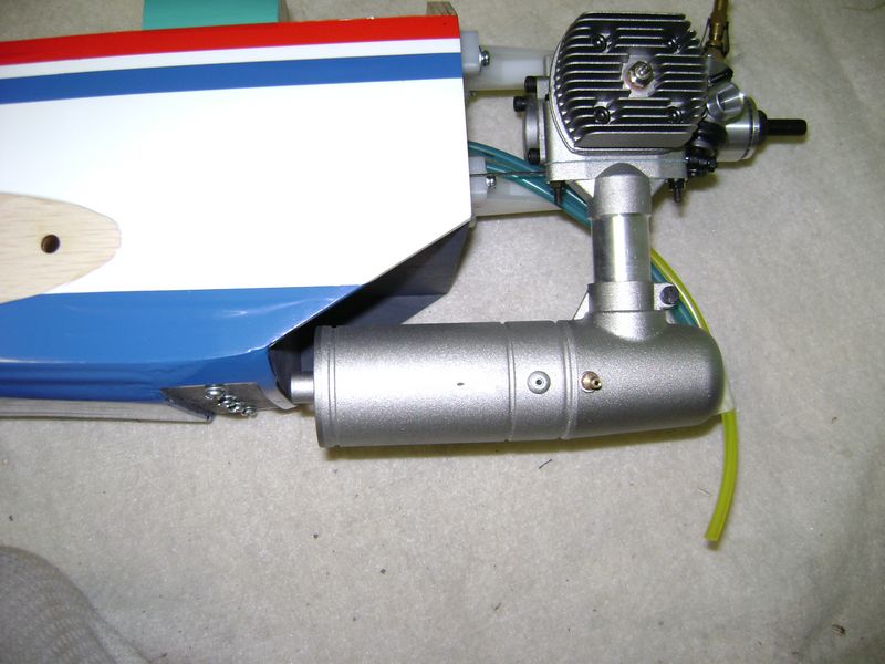

Thanks for all the help. While at work I was doing some thinking and what I decided to do was to exit out the bottom of the plane just behind the landing gear. When on my way home I stop at the LHS at talked to the owner and he said the he could order what I needed to fix my problem a long exhaust deflector. He said he did not think it would heart the performance of the engine so I ordered the part. Here is some photos of what I have so far. Take a look and see if this will be ok.

You need the exhaust to exit out of the fuselage. The way you have it now your plane will be filled with oil. I would find a 3"-4" piece of aluminum tubing that fit snugly into your silicon exhaust pipe to extend it out of the fuselage a couple of inches.

Hi I just used that exhaust deflector for layout. Just ordered longer wone.
