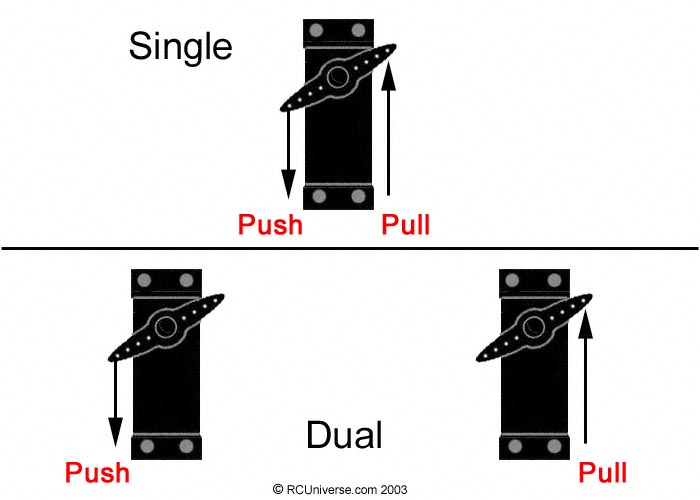

As Minnflyer said, Y harnesses typically do NOT reverse one aileron. But there are Y's made that will reverse one servo.
Also as Minn so nicely illustrated, setting up mechanical aileron differential is possible, and not difficult. I usually have my student(s) set up the trainer this way.

Both David Cutler and Minnflyer's comments in this post are correct. I've never met either, but have sorta known them for over a year via RCU. The are both knowledgeable and offer good advice. Minnflyer pointed out a way to mechanically set up differential. But with two aileron servo's, it is much easier to do in my opinion by programming the radio, as David pointed out.
Swager: With a 2 channel aileron setup, you still control both servos with one stick on the transmitter. The radio just "knows" to run two servos from that stick. It "knows" because you program the radio as such. With a one servos setup, the radio "knows" just to run the one servo, again because of how you programmed the radio. Hope that helps.
Davids comments were correct (as usual) The only thing he was wrong about was his comment about "Y" cords reversing the servo.:
A standard "Y" cord does not reverse the servos. You do not WANT to reverse the servos for ailerons. In the pic below, you can see that all 3 servos are going the same way to achieve the desired results.
Yep you are right, of course, about my slightly less than accurate comment about the Y harness reversing the aileron servos in this context.
I remember when I was writing it, that I didn't want to make my response too complicated for the questioner, and wanted to let him know that, when a reverser is needed, as in, for instance, dual elevator servos (because the servos themselves are mirrored and therefore are already reversing, and needed reversing back to unison again) it is available. (See? I can't say it simply!!!)
