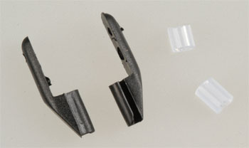

Especially when used right, meaning you have the Z bend on one end (servo) and a clevis on the other end (elevator, for instance) so you can do mechanical adjustments.
I've been using the L bend with quick-links that hold the L bend in place. I've had no problems at all with them at all.
