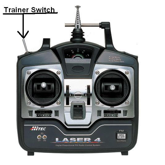

Ok, I'm going to get a buddy cord so my dad dont plant another plane without me at least having a chance to save it. I have a Futaba 6exp, and he has a Hitec Laser. My question is once I hook them up and have my transmitter turned on trainer mode, How does it work? Does my transmitter need to be on being its not on the same channel as his. What transmitter needs to be on. I think mine would have to be on being it has the switch to give him control. Can someone please help me I just cant get my mind to under stand how this works. Thanks.

Ok, His Laser will be that main transmitter for that plane. but it does'nt have a trainer switch. Do I need to set the receiver to work off my transmitter being it has the switch? I have an old futaba skysport transmitter laying around that we can use for the second.

ORIGINAL: millertym2000
That's weird. I have a Laser 4 and it has a trainer switch. This picture, from the Hitec site, looks exactly like my transmitter. If his is different you will need to change the crystal in his receiver to match your transmitter and use ity as the master.

you know I dont remember seeing that switch on his but it might be there,
