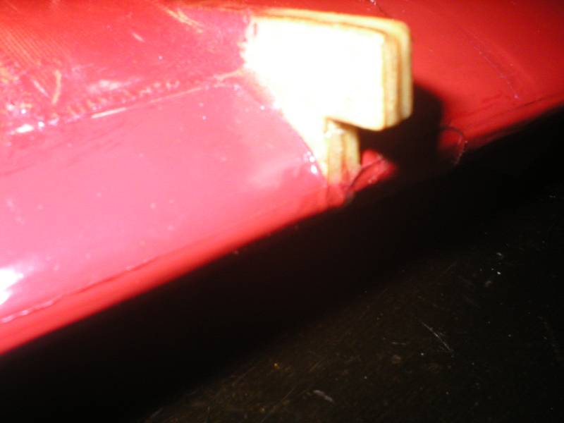

I think I'll have too go with Ken on this one - that peg 'seems' too be intact. Perhaps just too be beef that part up they should probably be thinking about installing two pegs like H9 has done with their Ultra Stick. I think you should just have a look at something else which could possibly have caused the crash if it wasn't the peg which sheared off. Just too be on the safe side since you are going too rebuild it.

If the wing had been secured like what you see done on planes that never lose their wings....his wing would not have popped off. A "single peg into F2" is a "Mickey Mouse" way of doing it for anything above .25 sized, or over 4 pounds.

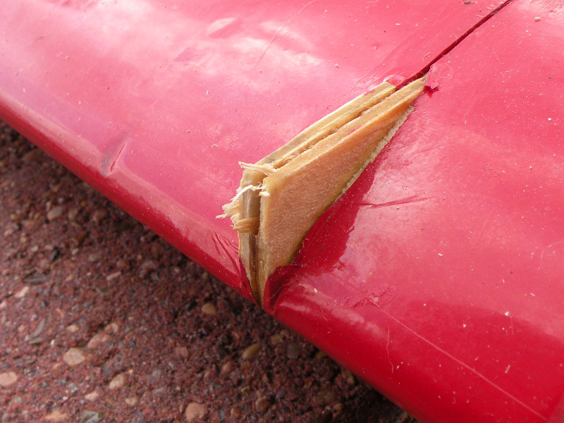

I'm not an idiot guys, I know why my plane crashed. The peg did in fact shear off causing the wing to not be attached to my plane anymore. You can see where it actually took some of the epoxy from the middle with it.

I wasn't saying you were an idiot. I was pointing out that from the angle in your first pictures I couldn't see the failure point and was simply asking about it. Now that you have posted this new pictures I can see the failure point.

I am going to play Devil's Advocate here, solely for your behalf...
The wing's front attachment design is actually quite adequate IMO.
Possibly, the airframe was overstressed due to the added weight, power & torque from the engine, and the twisting moments via 3D.
It's never a waste of time to consider all possible effects when selecting a powerplant.
Good luck with your next plane

If that same basic tongue design had a more substantial sandwich of materials, it would still be flying.
As the saying goes, "If you don't fold one every now and then, you're probably building too heavy". I would [after the benefit of seeing this failure] make the center ribs out of 5 ply aircraft grade wood and go double thick of what you show there.....I would also beef up the former in the area of the slot. The heavier center ribs could [should] have lightening holes judiciously placed safely away from the high stress area up front.
Then go thrash the plane for all it's worth with confidence.

I would drill a hole on each side of the peg and epoxy 2 dowel rods in the wing. Then drill 2 holes in the corresponding part of the former. This "should" hold it ok.
