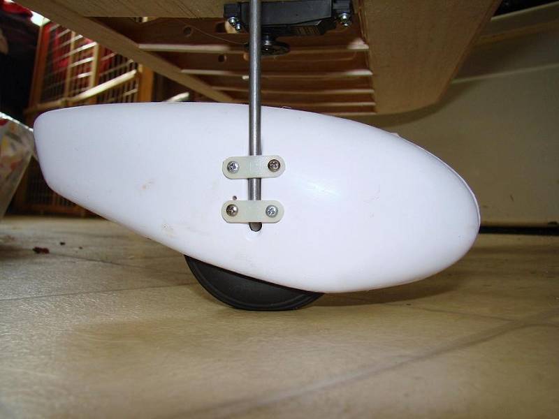

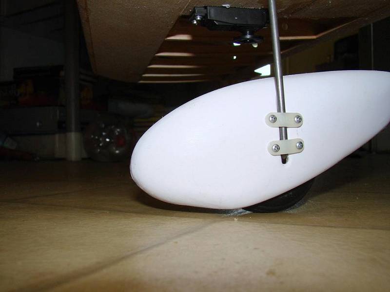

I am trying to use the wheelpants that came with my G.P Super Sportster 40 and came up with a problem.
I am building it as a tricycle gear instead of the tailwheel so in installing the main landing gear further back as instructed the front of the wheel pants are way too close to the floor, and with it being this close to the floor I know how much closer it will be on the ground. Close enough that one bounce would rip them off.
I guess that by moving the landing gear from the front of the wing to more center has somehow effected the orientation of the wheel pants. They were built as instructed so all is lined up proper, and I am using the recommended 2 1/2" wheels but building it as instructed has pushed the front of the wheel pants at a very sharp angle, with the tip almost touching the ground.
So I would like to know if changing the wheels to 3" would lift the front of the pants enough to not be an issue? I do not want to buy the 3" wheels if it is not going to help, I would just as soon not have the wheelpants on, although it really would have looked nice.
Would the premade ARF wheelpants fit the kit better?

The indentations in the gear intended for the gear wire are angled to accomidate the slightly forward swept gear of the tail dragger. To use the pants on your configuration you'll have to modify them slightly and mount them at a more appropriate angle. It shouldn't be that big of a deal to do.

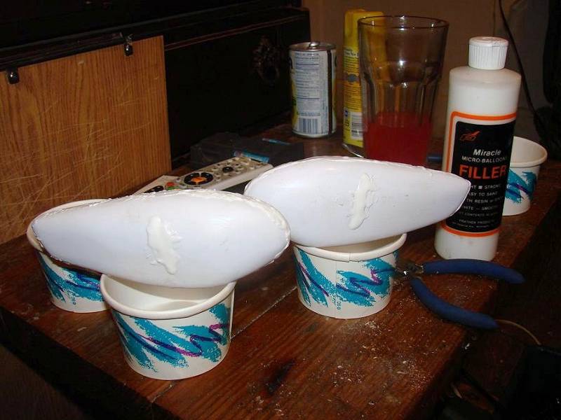

I just filled all the seams, holes and landing gear wire grooves with MicroBalloons and 30-minute epoxy, mixed apprx 3 parts MicroBalloons to apprx 1 part epoxy. About how long should I give it before it can be sanded?

Oops! guess I am a little late.  I was going to suggest using heat.  You could have used a trim sealing iron to re-shape the plastic so you wouldn't have had to use as much filler.  </p>
</p>
You should let that set up overnight so the epoxy won't load up the sandpaper as bad.</p>
