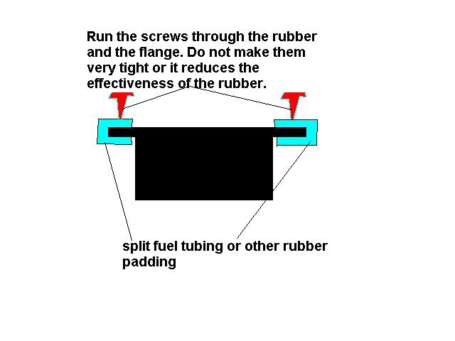

The radio systems recommended for the kit come with HS-55s. I think the 55s are worth trying, especially since you already have them. I drew a picture of how I would isolate them from vibration.
The 81s weigh twice as much as the 55s. They are definitely plenty of servo if you decide to go with them.
