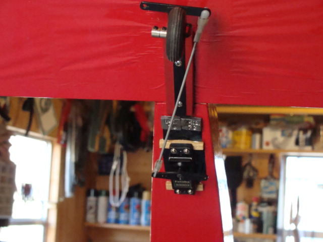

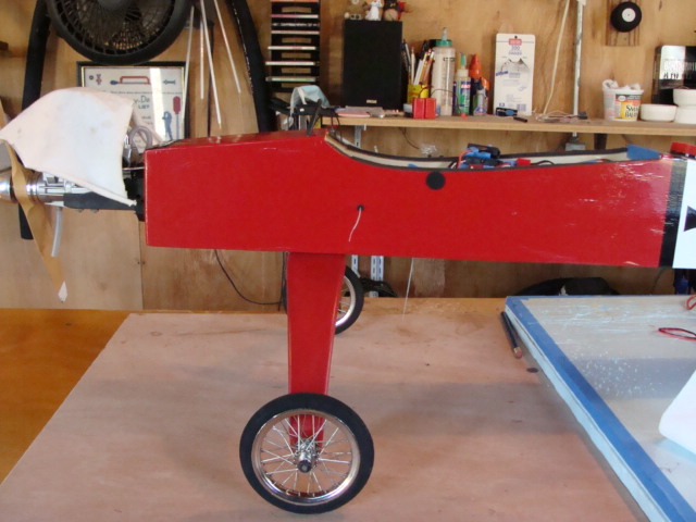

Mine is a 40 size, but here are some pics
Bob

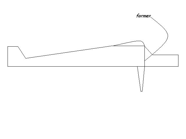

It looks like you have the gear placed so that the centerline of the gear aligns with the leading ede of the wing. But there's a former inside the fuse right at this spot. Did you have to remove the bulkhead/former to install the gear where you have it?
Old 10-11-2009 | 01:10 PM
w8ye's Avatar
My Feedback: (16)
Posts: 37,576
Received 11 Likes on 10 Posts
From: Shelby, OH
Default RE: Big Stik 60 Tail dragger
I've seen them in front of the former, behind the former and centered on the former
they all worked fine
The legs of the gear are at an angle
If behind the former have the wheels forward
If in front of the former, have the wheels to the rear
If centered on the former have the wheels forward
Old 10-11-2009 | 09:17 PM
Joined: Oct 2005
Posts: 1,993
From: Deland, FL
As w8ye said,
I split my reinforcement at the former,
so my nylon bolts are on both sides of
the former. My axles are just a tad ahead
of the leadind edge. I used a Level, vertically
to assure they where just that way.
