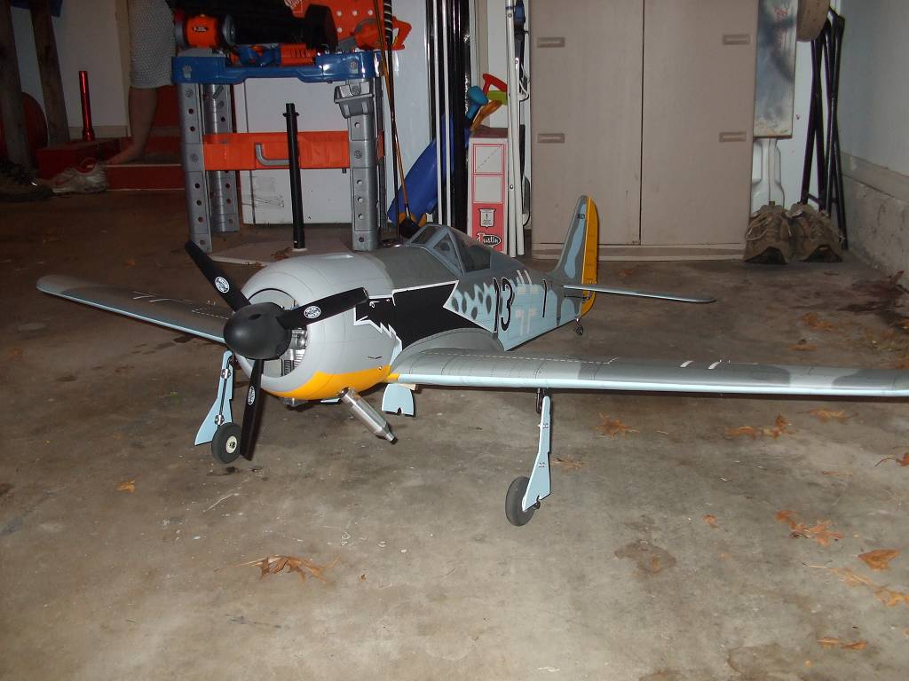

Just got the focke wulf finished up, just gotta adjust the cg. This will be the scariest maiden yet for me, lots of time put in on this one. I may maiden it with the cowl off too, dunno.

It does look pretty. You will be fine

Brett the plane is extremely stable and flies like a low wing sport plane. It lands pretty slow if you use the flaps. If you have some low wing time you should be okay but RCKens offer makes sense if your nervous.

Is it an ARF or kit?

That's a Kyosho ARF.

I think it's funny that you aren't scared to hang it up on that itty bitty hook.

And how much does the cowl weigh?
Lot's of people make 1st flights with the cowl off, never once considering what the removal of 2-3 ounces does to the CG.
And many do it because they have no clue how the new engine will run which suggests why lot's of them wind up deadsticking. Better to take a bit of time to get the engine running reliably. It's really good to have a reliable low end and an idle rpm you can trust that's slow enough and sure enough to give you a reasonable speed on final.

Great looking plane!

Very nice looker, good job.
