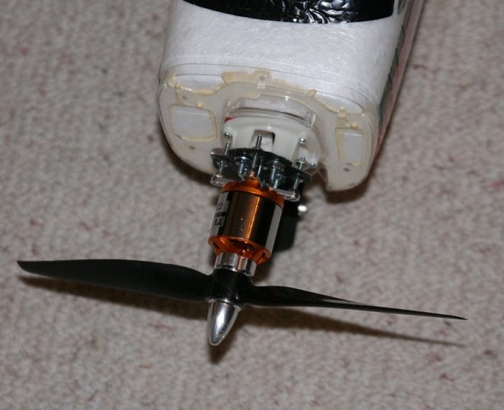

My son recently received the apprentice for a birthday gift. he flew it 3 different days and was a pro at it. He had a week of flight school last summer. His mistake was to let me dear old dad try. Take off was great and a couple minutes of flight followed by a horrible crash, I lost too much altitude and he couldnt take over in time. I ordered all the parts. (over $100) and want to know after repairs and glueing the fusalage and wing together will it still fly? also what do you use to hold the servos in the wing? 2- what do you use to hold the servos in the body? 3- is there anything to use to reinforce the fusalage and wing? As you can see I am new at this as am quite distraught at todays events.

I flew mine after a lot of different repairs & it always flew well.
By the end of its useful life the rear of the fuselage was held to the front by three flat pieces of carbon fiber epoxyed, one to each side & the bottom, the non-Eflite replacement motor was mounted using a cut up piece of sheet metal with some long bolts.
It is very rugged, very easy to fix & very easy to fly making it an excellent first plane.
When I improved after a number of months rather then replace major parts which were getting long in the tooth I moved to a balsa SIG Senorita as my high wing trainer. Except for the servos the electronics were all transferable.

can you tell me what replacement motor you used and did you have to modify anything to attach it to the firewall. Also where do you get the carbon fiber to expoxy to repair the fusalage. thanks for your help and encouragement.

I just put a Turnigy 36 48 in mine... LIke stock on 3S. Very spirited on 4S. But the cowl wouldn't fit...
And with the extra weight combined with the stress of higher speed maneuvers, Ifolded the wing during flight.....
It didn't fold in the center, it got too stressed where the spar/tube goes through the wing and ends near the aileron servo.
I'll have to see about reinforcing that.
