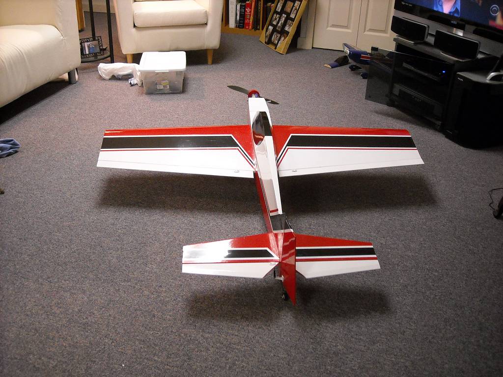

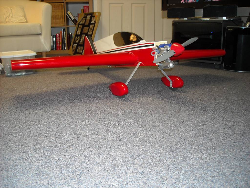

Finally!!! Whew. This ARF build really kicked my butt! Narrow fuselage made it a challenge for the elevator and rudder setup. But other than that it was just getting the time to make it right. balanced tonight. She's read to fly. Had to add 7, 1/4 ounce weights to the nose. Way tail heavy, but have read that about this plane. This was my first ARF that I had to install the hinges on and I learned ALOT about that issue. I think I'm ready for a kit! I know it will be much more involved, but I think I'm up for the challenge! I'm running an OS 46LA with a 11 X 6 APC prop (unless some one had a better suggestion).
Thanks for all of the advise. hope to fly it Wednesday. Will be sure to post a report. By the way. I found the pull pull setup to be an easy install, also ended up using a sleeved cable for the throttle, all works like a charm! At least in the basement
Here are a couple of pics. Can't wait to fly it.

Yeah I got the cowl with it. Not putting it on until I get the engine dialed in. It's a new engine, well only three tanks of fuel have been rain through it on the ground. I noticed that the pin striping up near the fire wall comes loose alot. I need a rx battery as well. I have a 1500 NiMh 4.8 volt. But with the DX7 I'm thinking it would be safer to run a six volt. But then again, only running four standard and one micro servo, it might be okay. But as Bob said "remember the five P's" so will most likely wait and get a six volt 2000 NiMh. Did you have to add alot of weight to the nose to get in balanced? I balanced my at 4.5 inches. I still have to check the lateral CG. I see that you cut out a large portion on the front of the cowl. Do you feel you really needed to cut that much out? I drilled a large hole in front of the carb. But looking at yours I may need to do a little more. Also looks like you ran pull pull for your elevator as well?? No they can't be, you would have to add another servo.

I have my engine mounted the same as one yours. I drilled a hole in the cowl directly in front of the carb, figure the carb needed more air to breath properly. Thought about mounting a servo on each side of the fuse for the duel elevators. Mine came with two small (seem like carbon fiber tubes) that go down through the belly pan, wing screw mount area, that keep them from dropping in the belly pan when you take the wing on and off. The battery I'm worried about becuase I'm using spektrum 2.4. Which I have read about "brown outs" when the servo loads cause the volts to drop below I think 3.8 volts. Rx basically shuts down and reboots. Of course by the time it reboots, the plane meets mother earth. I hope to be doing some KE's on Wednesday.
