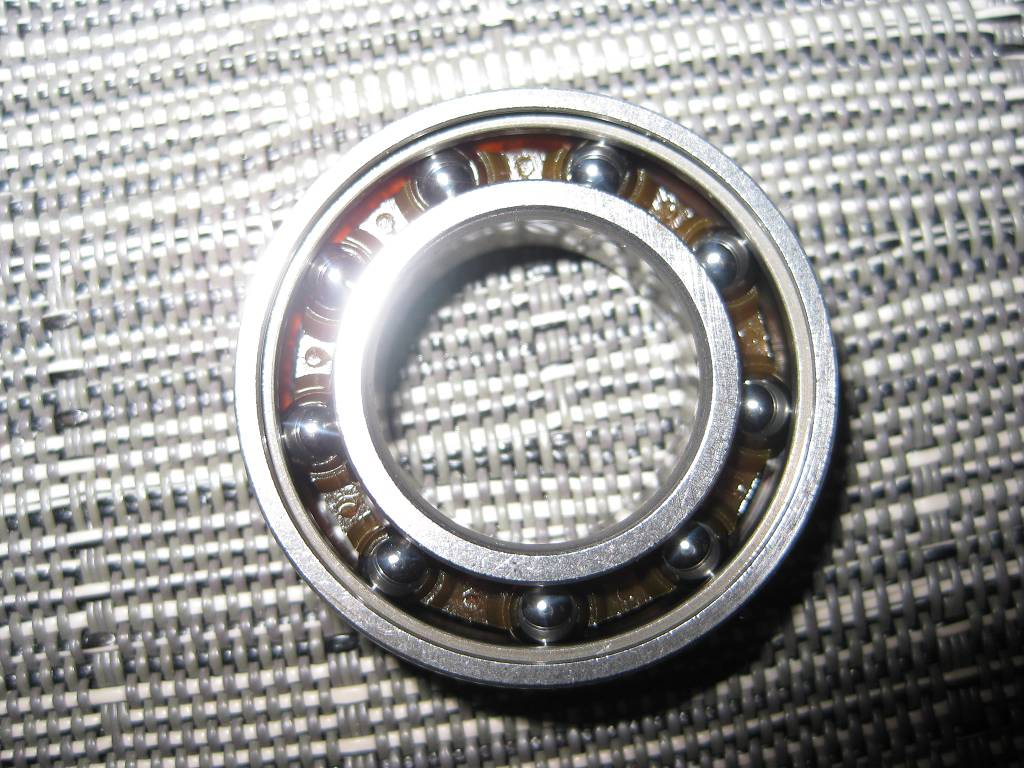

I just received a set of bearings for a 2 stroke engine. Im looking at what seems to be a plastic insert on the rear bearing(holding the balls in) Is this right???? Im skeptical due to heat. Has anyone else seen this?
engine OS 46AX

What you received is likely a sealed bearing which is packed with grease. The plastic seals aren't holding the balls in; they are just holding the grease and keeping dirt out. You can easily remove the seals with a sharp pick or something. Just be careful not to gouge it down into the balls and races.

Is that what im seeing? Im not to sure about that...but here are some pics. What do you think?

the pic to the far left looks normal....ive changed the bearings on several engines and havent seen bearings like the one in the middle ...maybe its not intended for high heat applications, or its a new "space age" material that can take heat
where did you get the bearings from?

The last few sets of bearings I got from RC-Bearings had the plastic cages. They are just fine. The old riveted metal cages are disappearing. The molded ball retainers has to cut production steps and cost down considerably. One press and it's in place vs the metal cages that had a rivet between balls holding the two cage halfs together. 1 pc vs apx 11 pcs.
A heads up though , one pair of that type bearings that I got from RC-Bearings were off size, internally. They fit the bore and the crank OK, but when assembled, there was a huge amount of ball clearance, they rattled when you shook the crank case. Another set solved that problem.
As for heat, the bearings shouldn't get all that hot. Remember, the crank case on a 2 strokegets a good gulp of cold air mixed with fuelevery rev and it all goes through the crank shaft, cooling it. I would be susprised if the bearing temp was much over 100 on a 70 degree day.

Actually all the same bearing. The first 2 pics show both sides.
I got the bearings from RC-Bearings.com.
The only thing i have to compare them to are the OEM units; and that piece is made of metal. Im questioning due to heat.

All of the bearings look normal to me for our R/C engines. The balls are held in their correct relationship to the other balls by those plastic "spacers". All of the bearings seem to be of the open type as is needed for our engines.

Those are the bearings you really want to use. The plastic retainers are far superior to the riveted or bent tab metal type.[sm=thumbs_up.gif] They wear better, have less corrosion issues, less drag and can take higher speeds. They are steadily replacing the phenolic cage type that were the king of high speed bearings.

I stand corrected. they aren't sealed; just normal bearings with a plastic cage. I guess that's what happens when you answer before seeing a picture.

One more thing to add about the old metal bearing retainers, is if a tab breaks off, or the metal retainer disintegrates, it goes through the the engine with (typically ) disasterous results.
There is no need to worry about the polymide (plastic ) retainer...they can also take the heat of a 4 strokes crankcase, which is much hotter than a 2 stroke.

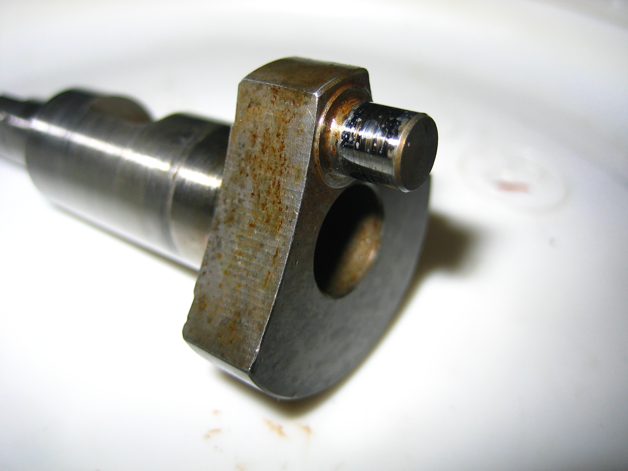

One more.....how should the con rod be positioned when reassembling?
Old 12-04-2009 | 11:48 AM
Posts: 4,987
From: Laurel, MD,
Default RE: Engine bearings...plastic insert?? huh?
what do you mean about the con rod?
On ABC engines like the OS 2 strokes, you just drop the piston/conrod assembly down, connect to the crankshaft, and then slide in the liner.
The big trick is not putting in the conrod backwards. Some engines have a non-symetrical conrod, and if you install it backwards, it might not fit, or it might fit and not get proper lubrication when running. When taking engines apart, I often use a magic marker to mark the back of the conrod so I don't put it together backwards.
Another tip, if the conrod is still attached to the piston, you can often tell which way the piston goes by the top. You get more blackening close to the exhaust port.
Hope that helps, or can you clarify your question a bit?
Old 12-04-2009 | 12:25 PM
My Feedback: (13)
Joined: Jul 2005
Posts: 2,322
From: Nutley, NJ
FYI: As far as installing the con-rod on the 46AX, one side of the rod has a bushing exposed and one side doesnt. The exposed side faces the crank shaft.
Engine is back together and just needs to be run again. Im not expecting any issues. Thanks for the help!

The bevel or chamfer faces the crank...the chamfer is necessary to clear the radius at the base of the crankpin.

OS46 AXcrank pin &con rod ...
ID:	1326679   Click image for larger version
