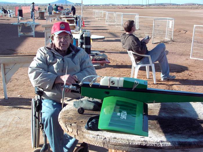

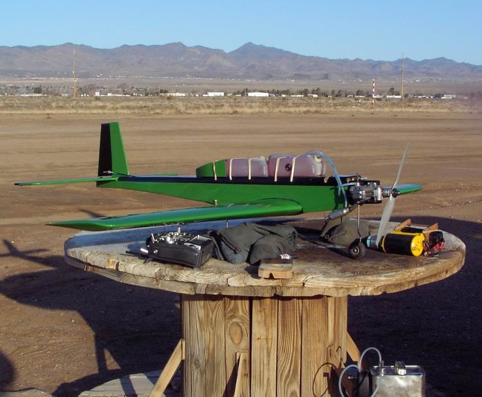

This is an example of the stacked fuel tank system with the plumbing illustrated by RCKen.
There is an eight ounce in the nose and two 24 ouncers on top of the fuselage for a total of 56 ounces and almost two hours endurance. This tank system with three tanks provide an effective way to carry a lot of fuel without the sloshing and subsiquient unporting of the clunks if a single large tank were used and surprisingly still maintains CG at least within reasonable limits however it is neccessary to continually retrim throughout the flight first up then down. The airplane is a Bridi Sun Fli 111 with an OS 70 surpass.

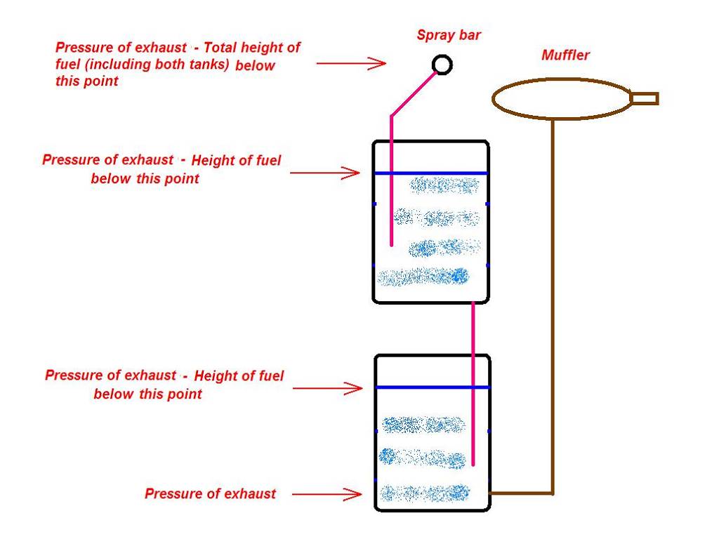

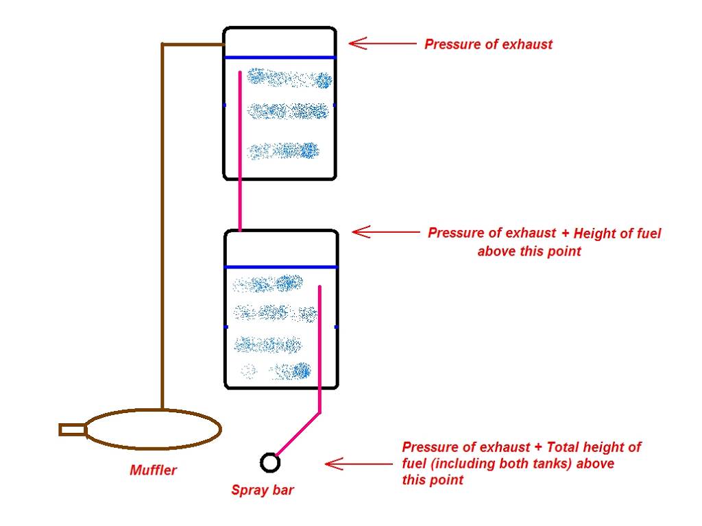

ORIGINAL: opjose
ORIGINAL: LNEWQBAN
I believe the problem with this set up is greater changes in the pressure that the carburetor sees for nose up and nose down attitudes.
For level flight, there is no problem beyond the added weight.
That would be true if fuel were compressable. Most liquids are not. It is the air ( or lack of it ) in the tanks which does this.
A properly plumbed system would incur no additional problems. e.g. plumb it like a Heli's header tank.
A header type plumbing arrangement, which is what should be used, only pressurizes or vents the very last tank in the chain.
So it is not much different from a pressure standpoint, from running a single tank.
That is true regardless the compressibility of the liquids or gases inside the tanks and hoses.
That is the only reason for which the fuel tank is located right behind the firewall, instead of at the CG.
The change in trim during flight is a compromise for good functioning of any carburetor.
A common form of Bernoulli's equation, for any fluid at rest (velocity = 0), is:
H + (P/Density) = constant
Where:
H is the height of the column of fluid above a point
P is the static pressure at a point
