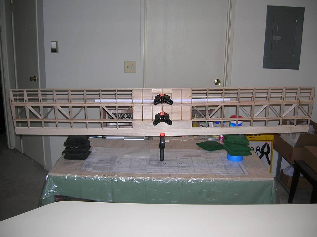

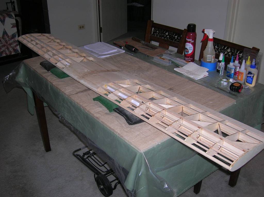

Here are some pics of the progress so far.
Looks like side mounting is the way to go. That was my original plan to side mount a Tower Hobbies 75 with a pitts muffler, but it's backorder is now pushed back untill late July so I went with the Magnum.
I am keeping the rest of the build completely stock other than adding another hinge so clipping the wing will be a hassle free option down the road.
