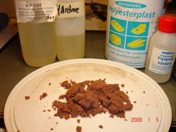

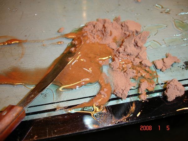

Old 03-23-2010 | 11:40 AM
Posts: 7,816
Received 10 Likes on 10 Posts
From: Upplands Vasby, SWEDEN
Default RE: gap filler with CA
Hi!
There is nothing compared to brown micro balloons and either 24 hour epoxy resin...or polyester resin.
