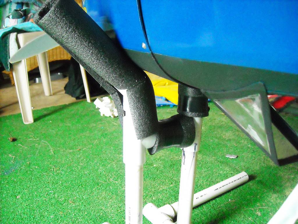

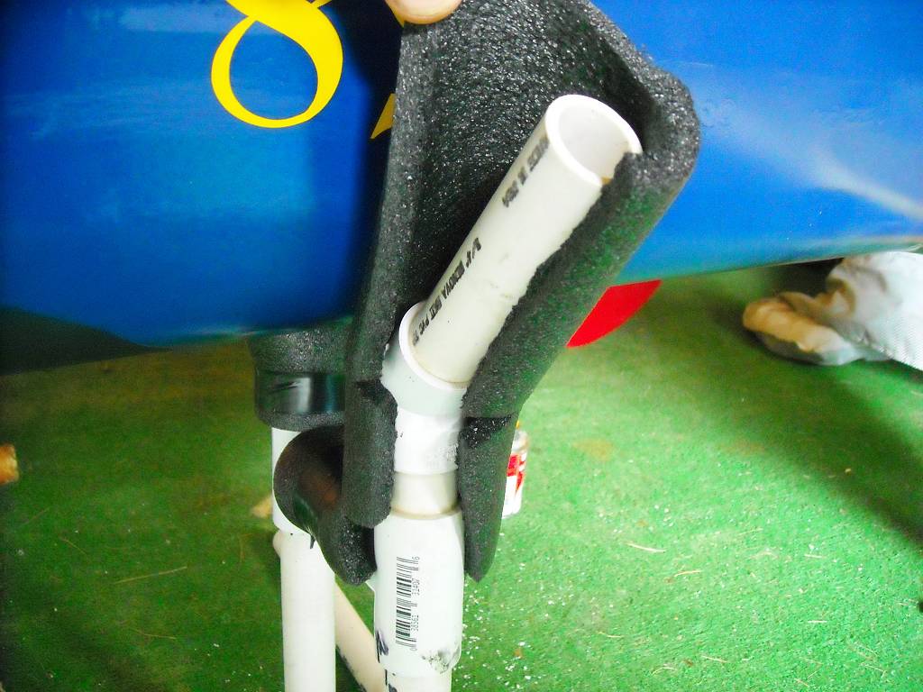

Would you mind telling me how to build that stand?
Mody

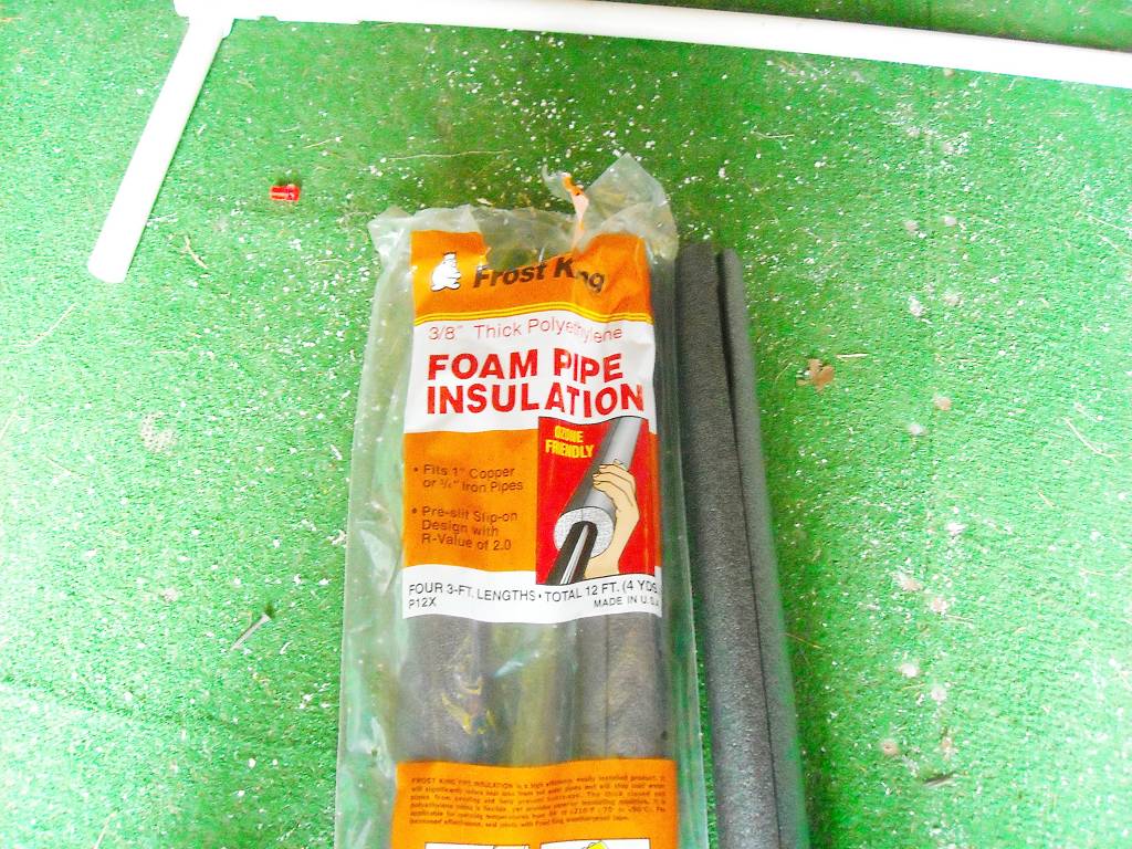

Easy. one 10 foot section of 3/4 PVC, 8 each 3/4 inch PVC tee's, 4 each 3/4 inch PVC 45 Degree elbows. The long lower peices are 30 inches long. The 4 uprights are 15 inches. With a 4 inch piece of PVC between each of the two upright ends. Just above the top uright Tee's I added another piece of 2 inch 3/4 PVC and attached the 4, 3/4 inch 45 degree elbows, attached 5 inch pieces of PVC to each elbow. Then wrapped the elbow and 5 inch pieces as well as the end cross suports with foam pipe insulation. Finally for side stability I added 4 10 inch pieces of PVC to the lower PVC Tee's. Be sure you have the tee's lined up correctly prior to sliding the pieces together as the PVC glue cures extremely fast! I used a multi purpose PVC glue that will give you about 10 seconds to make adjustments if needed. Some pics to show what I just stated are attached.

Thank you very much.
I'm gonna work on it and have my brother in law help me out.
