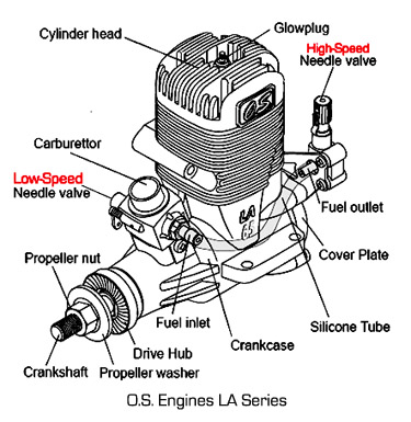

Both high-speed and low-speed needle valves do this:
Clockwise is less fuel == leaner
CCW is richer.
This is true for all glow engines that have two needle valves (like the picture).
Some lower cost carbs have an air bleed instead of Low speed NV. the air bleed screw works opposite. Opening it up (CCW) lets in more air and makes the mixture leaner.

The picture that you have posted doesn't correspond to the carburetor of your engine.
The one in the picture has a little hole at front for air intake thru the low end bolt.
