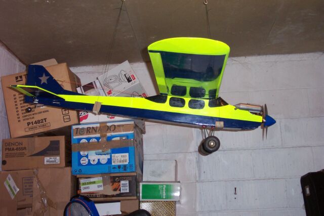

I converted my Nova 40 to a tail dragger, the main reason was that I needed to replace the mains anyway (the origonal ones were too springy), and I knew that I my next models were going to be draggers, so what the heck!
I did not find that the tail dragger was that difficult to control, just did some practice taxying, and a couple of practice take off runs. Sure, I have eaten a couple of props, but that was being a dumb thumb and garfing up a landing anyways. Just remeber to give her some up elevator when rolling out, and a nice flair on landing. If you do that you will be ok. As for the weather vane effect, sure you have to be aware of that, but it is easily compensated for by being ready for rudder input. Just be careful though, it is easy to over-compensate, and you end up chasing the plane around. I also make sure that there is no other flyers in the area when I am rolling out ... why push your luck on safety!
The setup is straight forward. Put the main just forward of the CG, and install a tail wheel. The wheel I used has a rod that hooks into the rudder so that it is steerable. I did need to add extra bracing to support the new main mounts. All in all it was an easy setup, and cost less than 10 bucks to get it done.
Here is a picture of the setup. Good luck with it ... Bo
