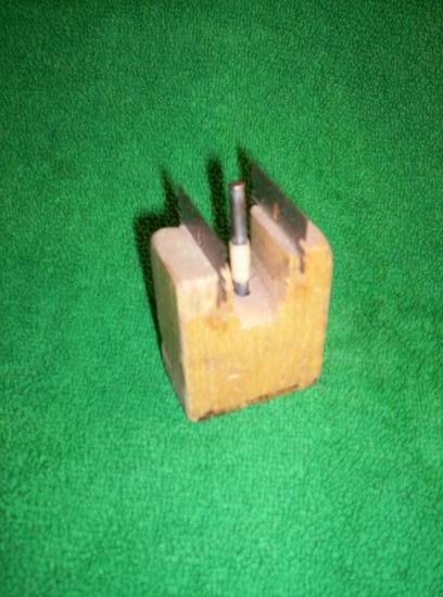

Just though someone would get a kick of my balancer I still have from the late fifties and early sixties. Even commercial fingertips were almost non existant so a couple of single edge razor blades, a chunk of balsa, an eighth inch steel rod and a bit of masking tape to fill out for differant propshaft sizes and you were good to go.

Ok John, yours has me beat. I used the finger tip balancer, and 2 disk drive magnets for nearly a jeweled movement. Do you get a little "edgy" around the razor blades?

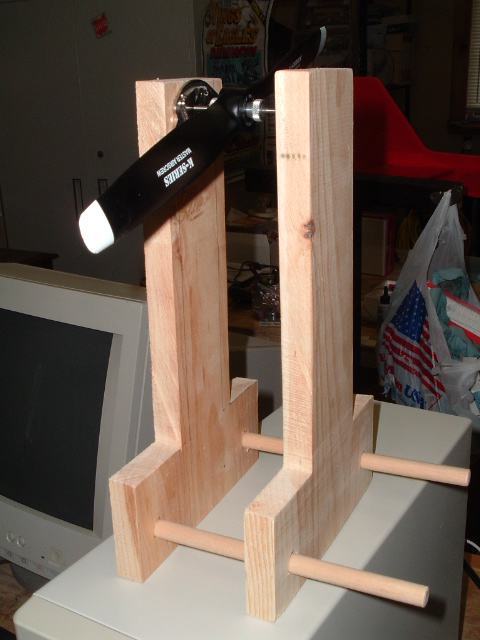

I balance all my props no matter the size or type. The manufacture may say that their props are balanced but from my experience THAT'S NOT ALWAYS THE CASE.
For all of you who don't balance props, I ask only one favor? Get another prop that's the same size to the one that is already on your plane, ( it can be a spare) or another brand new one to what you are using now and balance it to your best ability.
Now just for kicks, go to your favorite airfield and bring along that balanced prop, and fly the plane first with your unbalanced prop like you normally would.
Once you've landed your plane, swap out the prop that wasn't balanced and replace it with the one that is, and tell me if you notice any difference?
I did that little test, now I balance all my props. And when flying season is over, I rebalance my props again due to bug splats, grass and dirt. It can knock the balance off after a while. So, evey 6 months of flying, " or " If I notice unwanted sound vibration, I recheck the balance just to be safe. That's just me.
Nice Prop Balancer Bingo Field!
