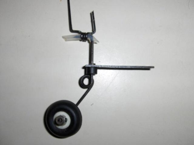

Here's one I added to convert a trike to a tail-dragger. The staple goes up into the rudder and the loop is cushioned with a piece of fuel tube. Worked great.
