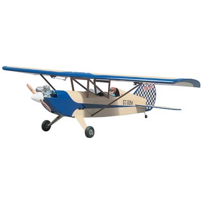

1 Attachment(s)
Originally Posted by I-fly-any-and-all (Post 12135679)
. . . or UCANDO 3D are excellent choices. GO FOR THE UCANDO! though it can be aerobatic, turn the controls down and with that big thick wing it floats and floats.
He's looking for a kit. Not an ARF. I have never seen a U CAN DO kit.
How about a Pete'N Poke? Scaleish (Pietenpol Air Camper) and not harsh to fly.
http://www.rcuniverse.com/forum/atta...mentid=2133828
