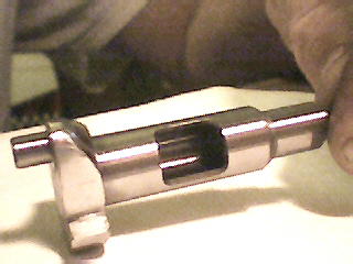

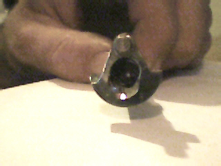

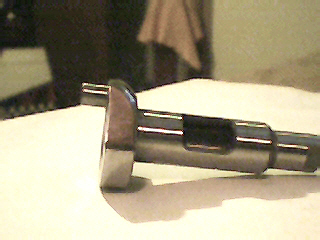

Joined: Jul 2004
Posts: 141
From: Arkansas city,
KS
just got done knife edging the intake of the crank and doing some work on the counterbalance like friction relieving the rh side and relieving the center hole, also angled the front side of the crankpin and then polished all the marks out and rounded all corners.... this is my first time for modding a motor and uploading pics.... so i hope it works !!!!!!! This motor is an os .25 fx airplane motor but i havent changed any actuall timing yet..... still pondering that part.... comments welcome.......... ok i give up how do i upload pics???? lol....... not as easy as i thought.
click this reply ---------------------------------------------------------------------^^^^
Then upload files is on the bottom of the messaga. Above the notify me box
Ryan
Ryan
Joined: Jul 2004
Posts: 141
KS
sweet !!!!!! ok. now i have to get back to the shop to finish a piece for a buddy so i can get back to modding this motor
like i said b4 comments welcome good or bad !!!!
