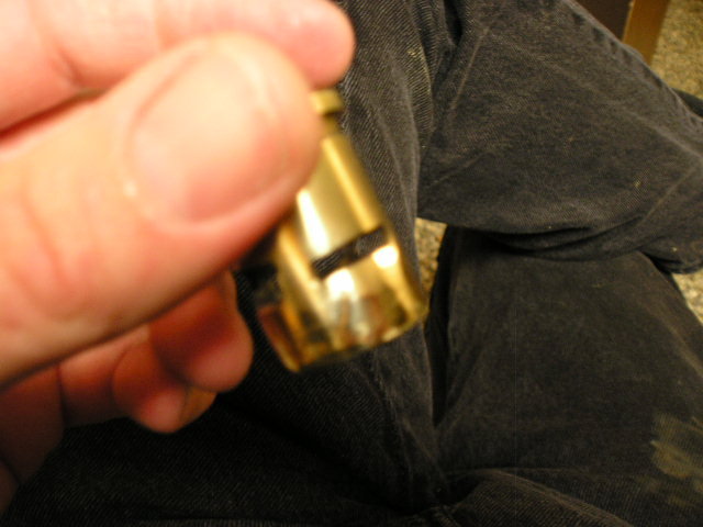

Somebody posted an article and pictures of how to do porting mods to the nitro engine. Would like to thank that person. I know there was some negativity to him encouraging people do do this and screw up their already good runing mill. But I did it similar to the pictures and am very happy with the results. I didnt gain much on the top end, but low and mid range is crazy now, the motor just runs better, idles smoother and smokes more even though I had to retune, but thats ok. I consider myself above average in small engine repair, thats why I went for it. The Mach 28 dynamite has only scalloped crank cuts, but nothing on the sleeve, thats why I noticed so much increase. Its awsome and BTW I'm just a basher not a racer.

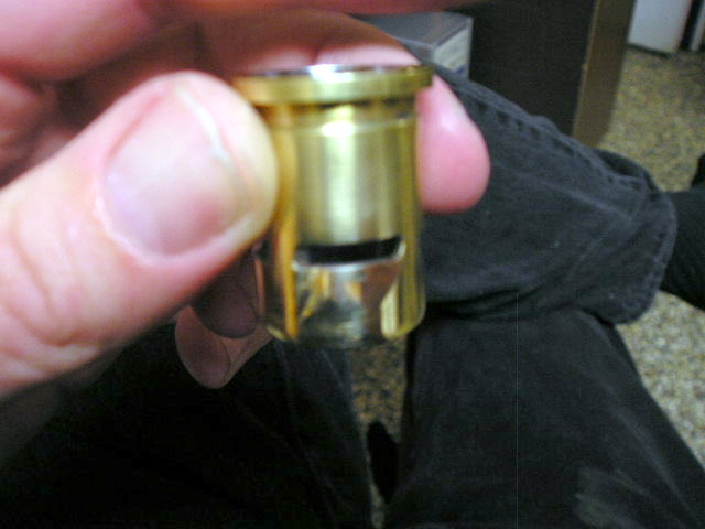

my camera wont take a good close up so mine didnt come out too good. Now if I knew how to post a video I have that. Here aew some before the install. I didnt touch the crank, I've read that polishing it makes the motor run bad because the fuel doesnt atomize very well or something like that.
ID:	603803   Click image for larger version

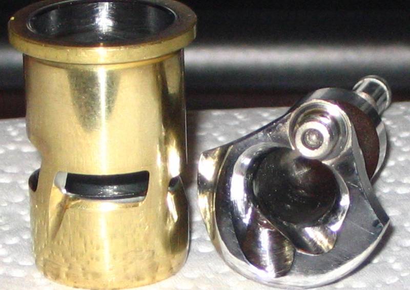

the mt.12 was my very first motor i did 5 years ago i still have that motor.
ID:	603859   Click image for larger version
ID:	603860   Click image for larger version

Very nice finish on the crank. I did just the same mods on my k4.6 crank, but the finish is very rough. Still have not figured out how to smooth it

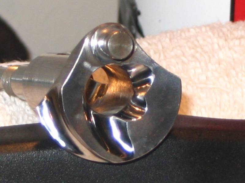

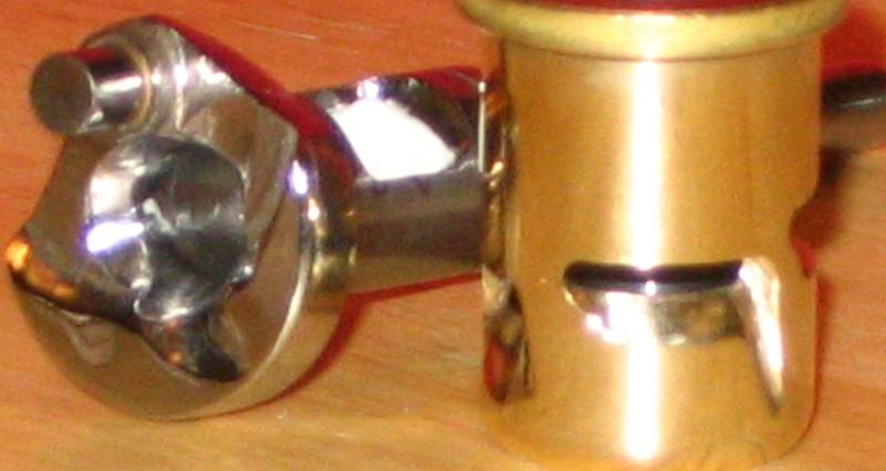

heres some pics of one of my mod jobs i did

ORIGINAL: Pro Twister Mods
supertib, dude i need that mill in your garage, send it to, LOL
Yeah the mill is sweet, its actualy my brothers, we currrently dont have the tooling for these little motors, so that crank in my pic is 100% hand done....

You need to get a rubber attachment, dremel makes one. Personally I use an old rubber dental tip from my work. But just a rubber polishing tip is all you need. Or the dremel felt tip with polishing compound works too. BTW guys I love the mod pics, this is cool, way cool.
