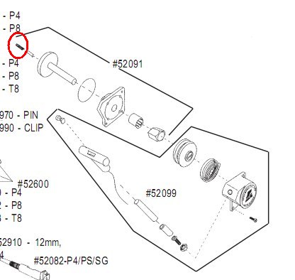

I went to fire up my Ofna Force 21 engine over the weekend and the pull start would not engage properly. I took the pull start off and turned the spindle by hand. There is some small movement in this spindle, pushing it does seem to engage the crank and pulling it out disengages it. I removed the end cover and removed the rest of the assembly, however, I am now unsure as to how this assembly actually works. I can see how the slotted drive plate engages with the crank pin for starting, but how does this engage and disengage? Any help would be welcome.

Should be a OWB (One Way Bearing) in there.....If your Pull Starts Not turning the Engine over .....Chances are the OWB's Slipping.....Clean the OWB and Try Starting it a gain....(Cleaning the Bearing Works most of the time)

there is a small spring behind the pin that sits in the crank conrod shaft.This maybe gummed up or broken stopping the pin from properly engaging in the cutout
of the starter shaft.

Thanks, that would explain it. I felt sure that there must be a spring loaded component somewhere and it is obviously the pin in the conrod shaft. I take it that this runs on the plate once the engine is running. I will check to see if this is broken or seized, it does seem a bit short I must admit.

on some motor's you have to grind the pin of the crank or get a alt crank to fit the bump start back plate.Meh at least its easy to replace

That pin must take a bashing. If that is the spring loaded pin inside the big end bearing then it is stuck fast and there is not enough protruding to get a pair of long nose pliers on it. Is there any way of getting this out without a strip down?

Have you got the pin out? if not the pin will push a small way inside the conrod bigend shaft before the spring full compresses. Shoot some oil down there and give the pin a light push in hopefully that will loosen it up.It only takes a few min to remove the crank shaft so it may pay to do that anyways.

No, seems to be stuck pretty good. A strip down wouldn't be a bad thing anyway and a good chance to give it a bit of a clean out. Can you point me in the direction of some instructions for stripping this down? Thanks

Job done. I found that a 19mm ring spanner fits perfectly over the three pins on the flywheel and this held it tight while I loosened the nut. The sprung loaded pin was stuck pretty tight in the crank but a couple on taps on a small punch did the trick. All cleaned up and free as a bird now. Now its time to get a cuppa, sit down at the kitchen table (when the wifes at work of course) and get it all back together again.
