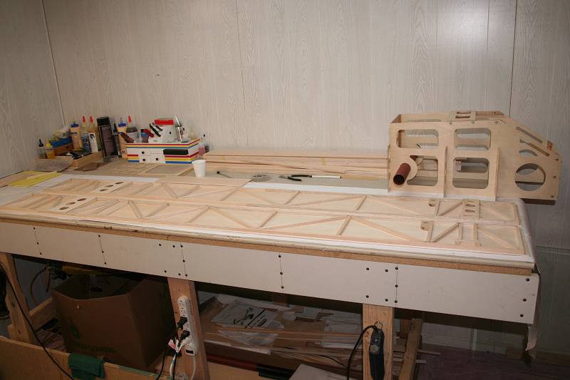

I got the kit a couple of days ago but had to finish a few projects first. The first thing I did was all the lighting holes on the engine box, which saved 15 OZ !
If anyone has any questions on hole sizes etc. feel free to ask. Here's some pictures.

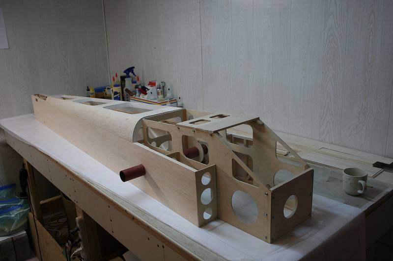

Engine box is done and all clamps were removed.

Does Dennis show all those lightning holes on the plans?
I'm looking over the 32% Yak I'm building and he just shows several round holes as before but all the build threads I've been seeing on 37% Yak and all the other 40% planes it looks like guys are really taking a lot of wood out of the motorbox now. I'm trying to decide how far I can go with this Yak. I'd like to really put it on diet as everyone does.

Hi Steve,
No dennis does not show those holes on the plans he shows four round holes on each side of the engine box and two on the landing gear plate. I have done this in the pass with excellent results, just make sure to make the corners of the "square holes" round instead of a perfect square. I also cut the landing gear plate 1" in front of the landing gear and replace that piece with balsa.

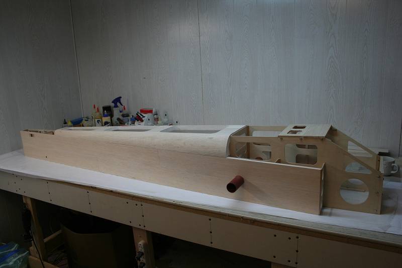

Bottom deck installed. I decided to cut holes on the bottom deck even after saying i would never do it again, it only saved two ounces ! I've talked to guys that claim savings of 4 OZ and I'd love to see how because the whole bottom deck all sheeted and with no holes weights 6 OZ., after all it is almost four feet long.

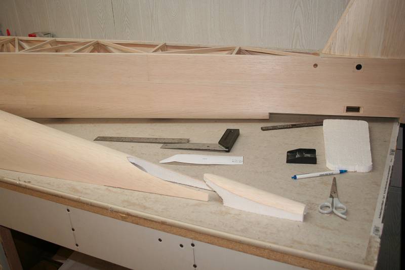

I decided to hollow out the front bottom pieces of foam, not to save weight but because they are much easier to fit this way.
The picture below shows the stock one on the right, the cut piece in the middle and the piece that was cut off on the left.
I'm including a picture of the "hot wire cutter" that I used.
I just wanted to mention that the stock one works fine and this is only more of an experiment for me than anything else.

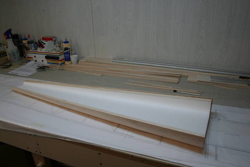

Here's a picture of the vertical stab glued in place. I highly recomend gluing the trailing edge to the vertical stab then gluing the vertical stab on.
