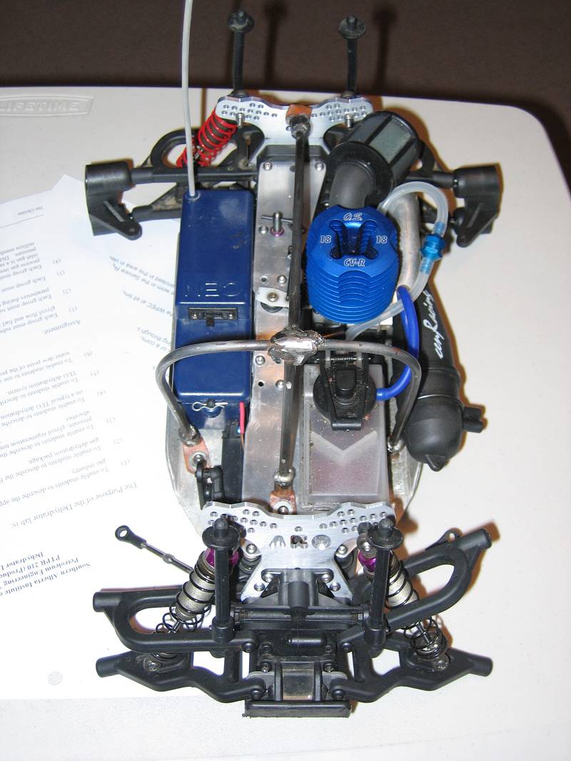

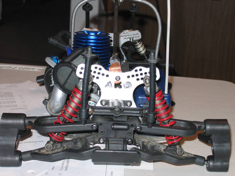

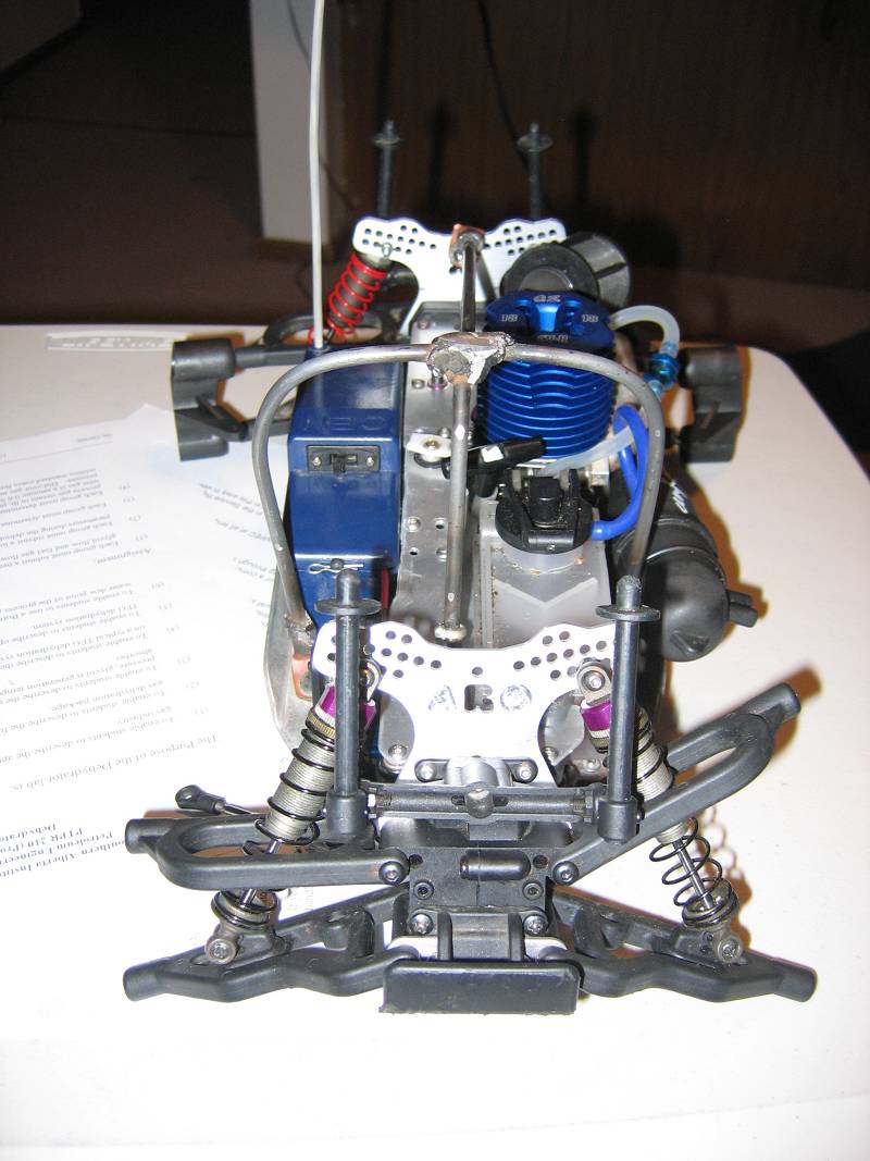

ORIGINAL: Dr Honda
Thanks for the advertisement alvinl.
I’m surprised… all those pictures, and no ARO shock towers??
We can't have that now can we... I'm still waiting for my buggy shafts and romulins but I'm getting soooo antsy because I've put all kinds of upgrades in it but have no stock shafts that arent broken so i can't drive it

nice and shiny shock towers

I like the battery / reciever box. Its the little things that make the difference.

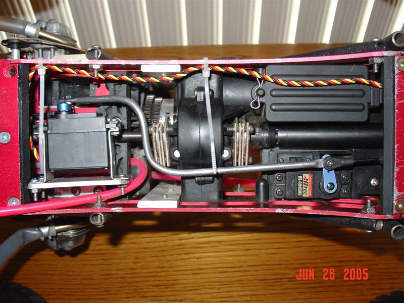

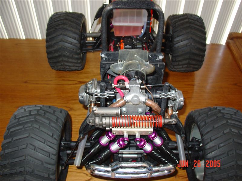

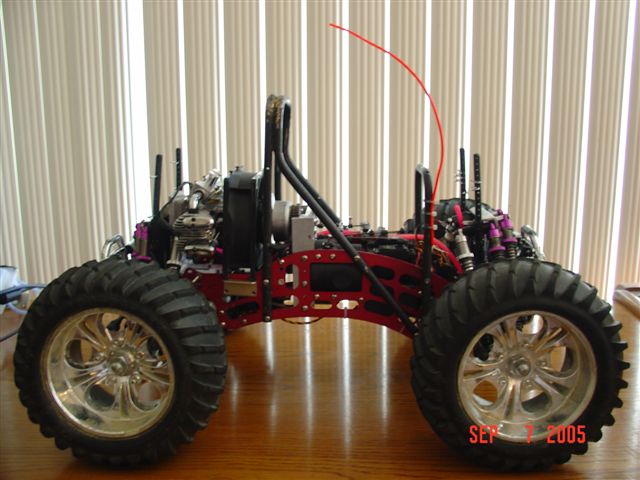

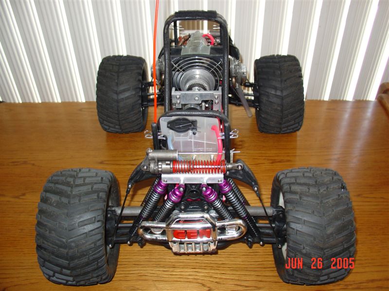

Not much new going on, waiting for the monsoons to stop[:@]
But here is my four stroke Genesis' evoloution in chronological order:

ah, now that is the daddy. loads of respect for what u have done there, my meddling has given me enough headaches, ur beastie must have been much worse/harder/more fun to get to work.
dare i ask... what plans do u have for a matrix?
forgot to ask... do u have any detailed photos of the valve arrangement on ur pneumatic wheels n tyres? something like that could very well work for my beach sessions on my truck.

No detailed pics with me. I found small inner tubes on-line but don't have that info here either, can get this afternoon. Basically I just drilled a hole in the rim for the 90 degree valve stem to fit through and added lead weights to try and balance the tires. I never did get them balanced completely and I did have high speed wheel hop but it worked good enough for bashing. The cool part was being able to adjust the pressure for different situations: full of air for big jumps and hardly any air for cornering.
As for the Matrix, maybe a smaller twin or large single four stroke laying on it's side. The cooling would be more of a problem to fix with the engine being so low. hmmm, Maybe two rotory engines..

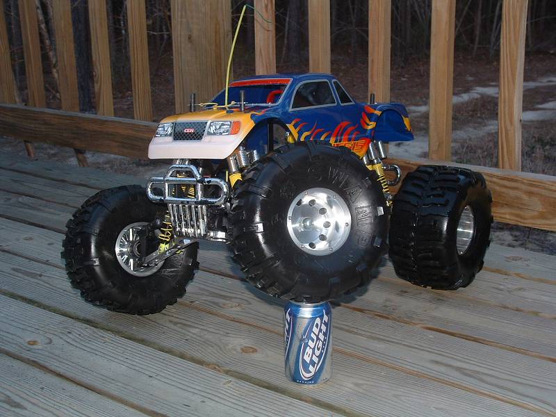

This is the Genesis w/ a new set of Jumbo Swamp Kongs and aluminum beadlocks. Havent been able to run in a long time due to moving. She's about ready for some bashin though!!!!

huge truck smack, looks very nice
