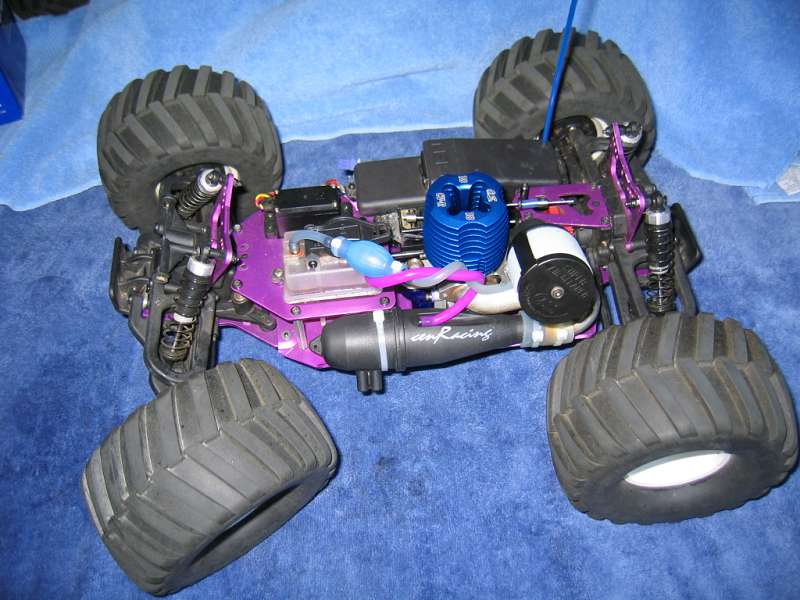

Can anyone help me? I need a little info because I must be confused. I just purchased a brand new OS .18 CV-RX engine for my CEN MT2 to replace the factory NT-16 engine. I heard it was the perfect engine upgrade. Well, it bolts right in, no problem there. I managed to cut the header bolts as well, so they are both flush with the exhaust header. My problem is with the flywheel. Am I supposed to use the flywheel from my NT-16? or purchase on specifically designed for the OS 18? Do I need a clutch adapter as well? I pulled the flywheel from my original NT-16 engine and it seemed to slip on the OS .18. The NT-16 has a longer threaded clutch shaft for the nut. The OS 18 seems to have a much shorted threaded part of the clutch shaft. I would even be glad to purchase a better aftermarket clutch kit for my OS 18, , , but, I just need to know whats the right parts to get. I have heard great things about those robinson racing clutch kits, complete with aluminum shoes, 3poles on the flywheel, sounds great. I am just confused, do I need to buy one as a CEN MT2? or as a OS 18... Thanks in advance to all....

u should be able to use the whole cen assembly on the os engine - i have on mine. i think cenracer has on his too...

ok thanks. I will try the flywheel again. I noticed that the NT-16 flywheel fit snug threaded all the way to the clutch hub. On the OS 18, when I installed the NT flywheel, it was loosely spinning after getting beyond the short threads of the clutch shaft on the OS engine. Was this the same for you? So your saying, that I should always be using the flywheel, clutch, springs, clutch bell, etc. for the model of vehicle that I have. So its based on the vehicle, not the engine. Right? Thanks, I probably did not spend enough time checking out how the flywheel from the NT-16 fit. Just quickly assumed it was wrong because it did not fit the same at first view. So if I decide to use a better 3pole clutch with aluminum shoes, I can go ahead and order one, as if it was for the CEN MT2. Right? I saw lots of good hopups for the CEN MT2 on the www.neweramodels.com website. They have a good selection there. Hey, thanks for the reply back. This is my first time to change engine types on the MT2's. One of my MT2's has the Epic .18 engine, but, I bought it that way from a friend of mine. I wanted to try the OS 18 because I have heard its easier to tune and a little faster than the Epic. Thanks to all. I will give a detailed post, comparing all 3 engines for the MT2, after I properly setup and break-in the OS 18. Thanks.

I thought the same thing at first, then I put it together anyway and it was a perfect fit.. no mods at all except the exhaust bolt and the linkages.... stock clutch works well, can upgrade to aluminum but car has enough snap for me... it blows tires loose as it is ... enjoy... its like driving a new truck...

Hi CenRacer. Thanks. I will keep the NT-16 flywheel and clutch stuff. I will re-install it tonight. Thanks for the info. [8D]

Thanks CenRacer. Yep, you were right. The OS .18 uses the factory NT-16 engine's flywheel and clutch set. I fired up the OS using the pull starter and it ran on the first try. I had it idleing for a few minutes. It ran perfectly. I just changed the pull starter to a tiger drive adapter, my personal preference. One quick press from my 12volt drill and the OS runs again. Thanks again for recommending this engine. It looks great. I love the large heatsink on the OS. I wish that CEN offered a larger heatsink for the factory NT-16 installed engine. Now its time to properly break in the OS engine. Im looking forward to this weekend to see what this baby can really do..

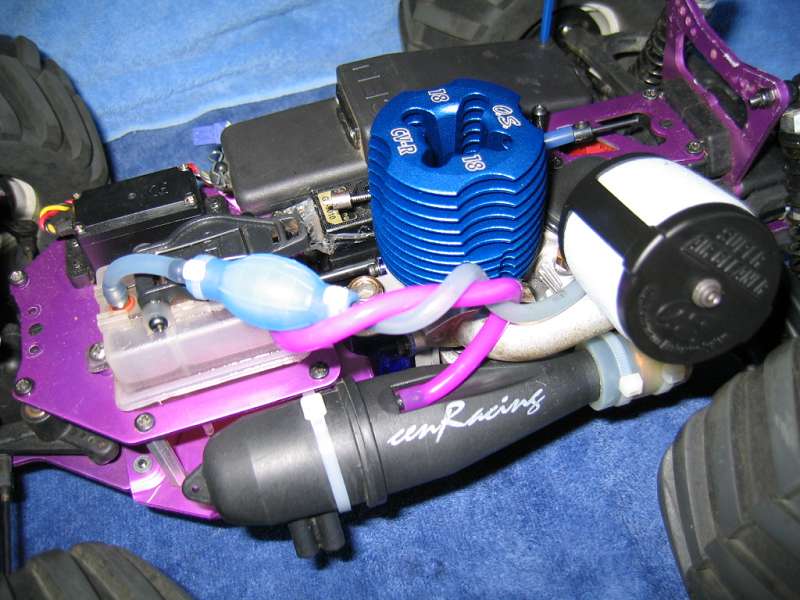

Hi Everyone. Here are the pictures of my MT2. Just installed the OS .18 Engine today. Fits perfectly. Thanks again to CenRacer, all I needed was the factory CEN NT-16 flywheel and clutch set. Everything fits great and the OS engine fired up on the first try. I love it when that happens. You can see the tiger drive adapter attached to the OS engine in the photos. My personal preference. I cant wait to run my MT2 on the weekend.

That is a great looking truck there. It may be advisable to pick up a New Era roll cage at some point though. That motor is going to stress the chassis considerably more than the NT16 and the roll cage stiffens up the chassis. It will also keep that cooling head scrape free.

lookin good - hope u fitted a failsafe! the truck takes some stopping with that 18 in there. we await another rave review from a newly foolishly grinning os18cvr owner!
like scouser says - its well worth some reinforcement in there, have a look around on the forum if u cant get the roll bar, there are some very easy and dirt cheap solutions. none that i remember will protect that shiny blue head tho...
btw - it starts that easily u shouldnt need the rotostart thingy, but hey, each to their own! enjoy!
