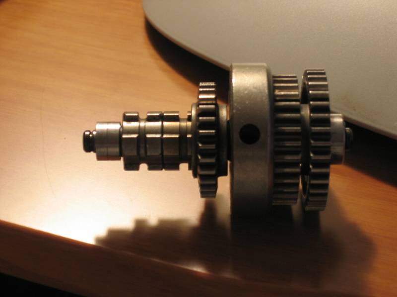

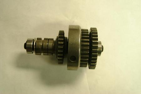

I found this thread on how to lock the transmission:
Removing Forward / Reverse:
REMOVE: GS069 shift lever, GS086 reverse gear. REPLACE GS086 with a second GS054. Then minimal shimming is needed.
This locks the transmission into forward.
Per Andrew Smolnik
Does this mean I need to put two GS054's on the shift unit? I tought I could use the lock block to do this?
Per Andrew Smolnik
