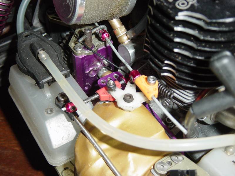

Right - easiest if I just post a pic of my linkages I guess. Aye they can be a pain to set up - ah especially if u have a slide carb like me... doh. I had to upgrade my throttle servo to get enough braking force with this linkage setup and the big wheels n tyres...
Have a rummage in the rcu gallery for cen trucks too, should get some ideas there, most are setup in a very similar manner - btw, did u strip the brake down and check its all ok in there? The plastic piston can melt - trust me on that one...
As for the temps issue, I dont think it will hurt to have a thread for temps, its a common question mate - I dont like to advise on temps, but people generally reckon 250-280 F is somewhere near... I think. I go by the smoke (from the trucks pipe, not the crack pipe) and performance - havent killed a motor yet thru tuning... yet...
Ill stop waffling and post any pics I have of linkages...

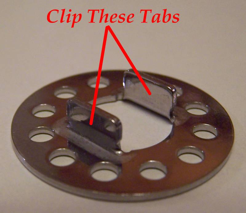

RogersRacing, you say you have the alloy brake disk. Did you install it or was it installed when you bought it? The reason I ask is I installed the alloy disk and metal plug in my son's ATX and had binding issues like you described. The metal disk has sharp corners on it that caused it. I dremmeled the corners off and it got a little better, but I still need to work on it a little more. I plan on making it rounded instead of squared off. Just a thought.
Edit - Sorry, i did not do a good job describing it. If you need, I will see about getting a picture of the part I am referring to.

I had the exact same issue with my metal brake disc. It took me a very long time to finaly figure what was going on because every 1/2 turn it would bind up. I thought i had my mesh wrong but after remeshing maybe 8 times with no luck i looked at the brake which WAS rotating freely but the little metal tabs were catching. I cut them right off and now i have no problems. Actually between that and the alloy brake seat, i have to be careful not to give it full brake or it will flip forwards on me
I hope your problem is that simple RogersRacing. Although if it is you may just feel like banging your head against a wall repeatedly.

Yes please, a pic would be good. I havn't had any problems with it before now. The alloy brake block was already fitted and has worked fine up until I replacved the spurs and clutch bell.

Here is a picture of a new brake disk. In the picture you can see the two tabs on the disk that I pointed to with red lines. This is a new disk and I have not ground anything on it. What I did with the one in my son's ATX is to grind the corners off of these tabs. This helped, but did not completely fix the binding. I think Dustin7837 clipped the tabs off, and I may end up cutting the tip off to make them work better. I also think Poor Judgement had a similar problem and shortened these tabs to fix it. PJ is who gave me the idea to modify the tabs when I started having problems.

I dont know what cen thought they were doing when they made those brake discs. They must have meant the tabs to keep the brake disc stable but they miscalculated the length. And yes I did grind those tabs right off. I did them halfway at first but it still bound a little bit on me so i just got rid of them completely.

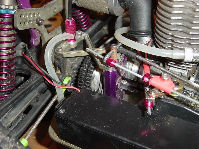

Heres some linkage pictures that might help.

OK Brains trust, I have just stripped down again and confirmed my suspisions....the tabs are already gone off the brake disc.
It seems that it only takes light pressure on the bell to release the bind so i reckon i'm just gonna fire the sucker up and any little edges that are catching will soon be mince-meat anyway!!
