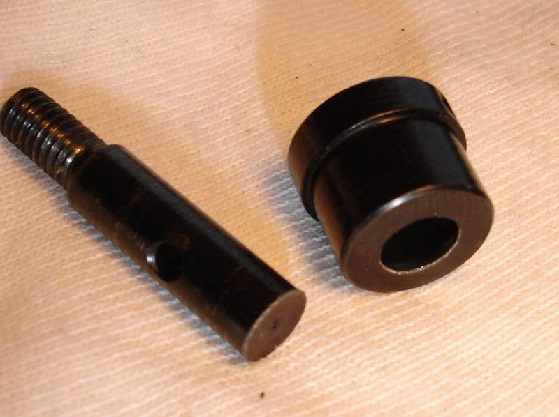

Got some of the shaft mod parts in today including thediff cups. Man they are beefy compared to the cen ones
Rolland,
When you ground them down to fit in the diffs, did you also drill a hole for that pin to connect them? And do you have any tips on grinding them down?
(sry for the poor pics couldn't get my cam to focus right...)

I didn't use the center pin. I have had no problems with out it and Poor Judgment says he hasn't either.
As far as the grinding part just take it slow with lots of trial fits. It is easier to remove metal than to add it.
Try to remove the same amount of material on each side for the flats and I beveled the outside of the cups a little bit for clearance. You will also need to clearance the shock towers a little bit. On the ARO towers I just rounded them over a little bit.
Here are some pics that might help.
I forgot to add that I shortened the cup section to around 14mm.

I FINALLY got all the parts together to do the shaft mod lol. When you guys did this mod did you use two 16*8*5 bearings on each hub? Thats what i have tried but there is quite a bit of wobble. I don't know if i can get 16*8*6 bearings but even if i could i wouldn't want to spend the extra $$. Did you guys use any shims or anything to get the wheels more stable??

all I needed was a 1mm washer on each side and it tightened right up. I only have the back done because I accidently only ordered 2 shafts instead of 4 and then by the time I got the other 2 shafts I lost one of the hubs [] lol.
So now I am waiting for more hubs to get here. Plus, I sent DR. honda my front diff and diff internals. I do have a spare plastic diff case so I was able to put it together and I took the buggy shafts apart and used the wheel end (not the shaft) and put them in the stock hubs up front So I could put the romulins on and run it 2WD.
Works great and looks so much cooler with maxx sized wheels. I just put some bowties on for now as the komodos are expensive[X(]
Only one other thing I noticed, I didn't really want to grind those drive cups down more than i had to so I ground about 2 mm off the Upper arm where there was contact. Oh an do you have any issues with the rear turnbuckles hitting the exhaust? Mine rubs when the suspension travels about half way down. I have a slighlty longer set of lunsford titanium turnbuckles (boy are the 4 mm ones expensive) for the back and front on the way, so hopefully they are a tiny bit skinnier in the middle and will resolve this problem.
I gotta say how much I appreciate you doing all the work and research to figure this mod out. *gives rolland a standing ovation*
