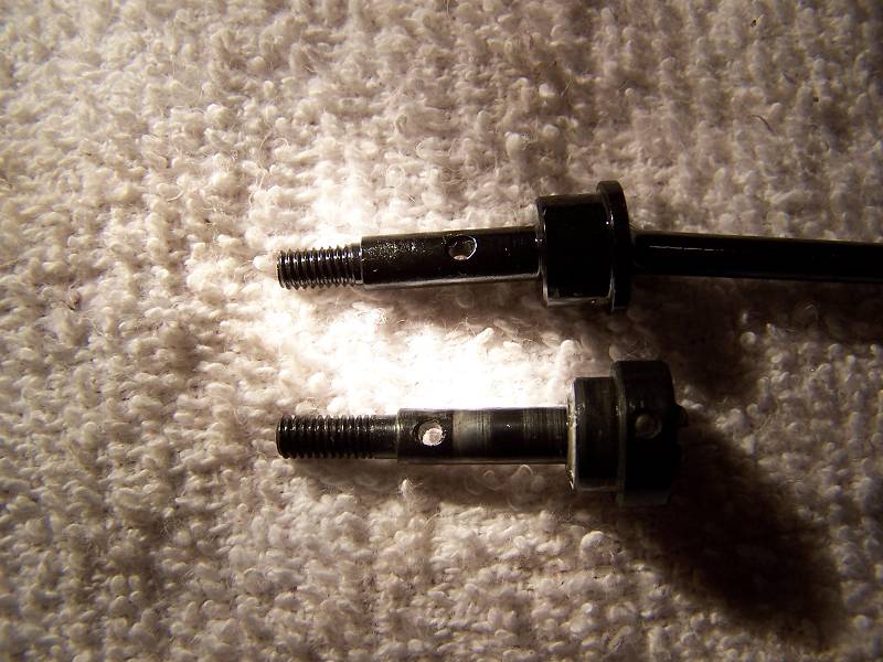

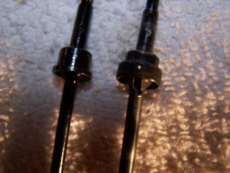

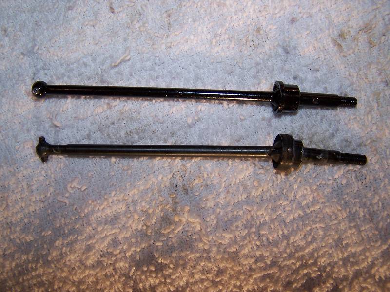

I got my Integy Jato CV shafts today from RCBoyz on ebay. Great service as usual. Just wanted to post a couple pics of the new CV shafts compared to the stock CEN MT2 shafts so everyone can see the difference Joesepy was talking about. The first picture is a close up of the shaft ends where it goes through the wheel hub. The broken shaft is the old one off my MT2. The second picture is a comparison of the stock CEN MT2 shaft with the Integy Jato shaft. The last picture is a closeup of the swivel joints in each axle. Take a look at the stock MT2 shaft on the right. Does it look like I have a little extra wear in the groove where it swivels?

Old 02-05-2006 | 01:24 AM
Joined: Apr 2005
Posts: 1,713
From: _, AB, CANADA
Default RE: Fun Factor ST/MT Shaft replacements
Lol. yeah, a little extra wear in that groove. Do they feel more solid than the sstock ones? Let us know how they work out for you.
