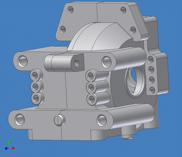

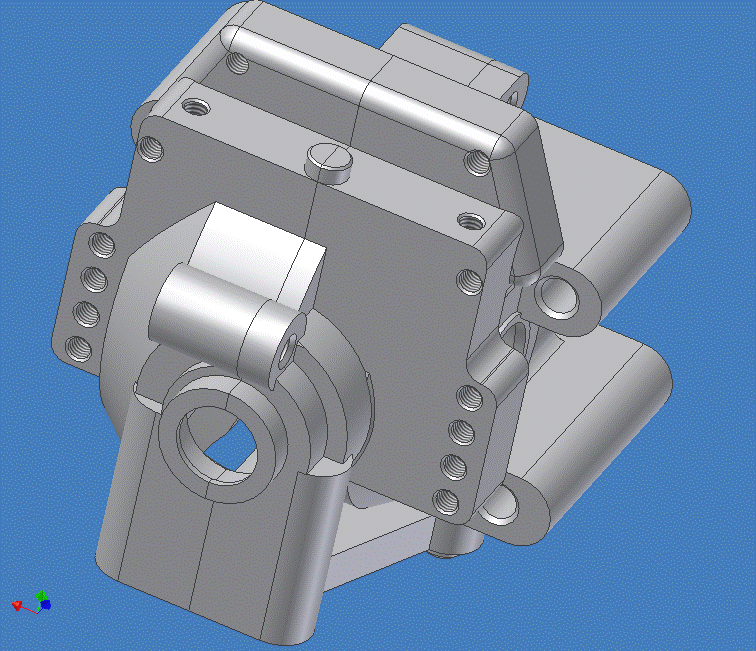

Alright - Here are the new drawings
Things I changed:
1) Mounting holes on the front. Deleted top hole, added hole in center of other two mounting holes, offset bottom hole to compensate for bumper mount.
2) Added locating pin and holes on back for rear aluminum brace.
3) Added more mounting holes for tie rod mounts
4) All holes (where possible) are thru. holes. 3mm x 0.5 thread. All holes are chamfered both sides. (Any fastener length from any side for more options)
5) Checked measurements of shock tower mounting holes. Seem to be ok. Checked dimensions of piece with 4 shock tower mounting holes....appears also to be ok....drawing still looks funny. Left the locating pin off as I can not find the error to fix.
NOTE TO DR.HONDA - maybe the first set of cases, have your machine drill the 4 shock tower mounting holes like 0.25mm deep. Then place on your shock towers to see if all the holes lign up. If not you will have to let me know of the changes.
I'm happy with these drawings. Is there anything more that needs to be changed before I send them off?

The diff cases look great. The only problem is, they are not going to be easy to make. Hummm… Perhaps it’s time for me to fit a fourth axis to my machine.
(it’s good for a tax write off)Poorjudgment…
On your chassis drawing… is the over head view assuming the angle in the chassis, or is it a flat representation? Also… can you tell me what the actual angle is on the nose of the chassis? Just as a verification… the braces are flat… right? Lastly, is 3.2mm (1/8â€) good for the chassis pan, or would you like to see it made out of something thicker?
The chassis are relatively easy to make… so I’m going to work up a prototype in the next few days. So… for all of you guys who wanted a JT chassis… be on the lookout for the ARO Products version. (thanks to Poorjudgment)
the angle is 30 degrees for the kick up.
yes, the braces are flat.
3.2mm should be fine for all parts in 6061 as the jt chassis is 3.2mm.
as for other bracings, all rebates in the chassis etc - we could do with knowing whether people want:
1. the rebates in the chassis and braces as per the jt design or a plain flat chassis (cheaper but not as funky)
2. extra holes for roll cages or whatever
3. any ideas as to changing the braces, making a single piece brace, or whatever ur thinking of
just some basic drawings on a photo would do to give us an idea - easier and quicker to understand than words!

I agree with you, those cases will not be easy to make... I will send you the drawings to start playing with this weekend.
