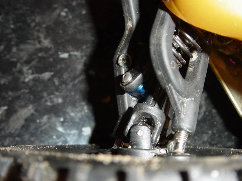

found and easier solution at 5:00am this morning... I didn't have any longer shock ends so i made a little spacer out of some spare black plastic that I cut to fit... Put it in the bottom hole and used a longer hex screw and lock nut... works like a charm... turning is full lock to lock and nothing hits... the only negative is I lose a bit of shock adjustability with the bottom mount... I don't know why but I do my best thinking at 5:00am with a cup of coffee and the misses and the kids still asleep... At some time I will try and post some pics with the progress and also the new body in place... Thanks again to poor judgement and azzman for the help... by the way PJ... I like your drawing, but i already made all the axles and don't want to modify them again... looks like a good idea however and i probably would have done that if I wasn't this far into this design already...

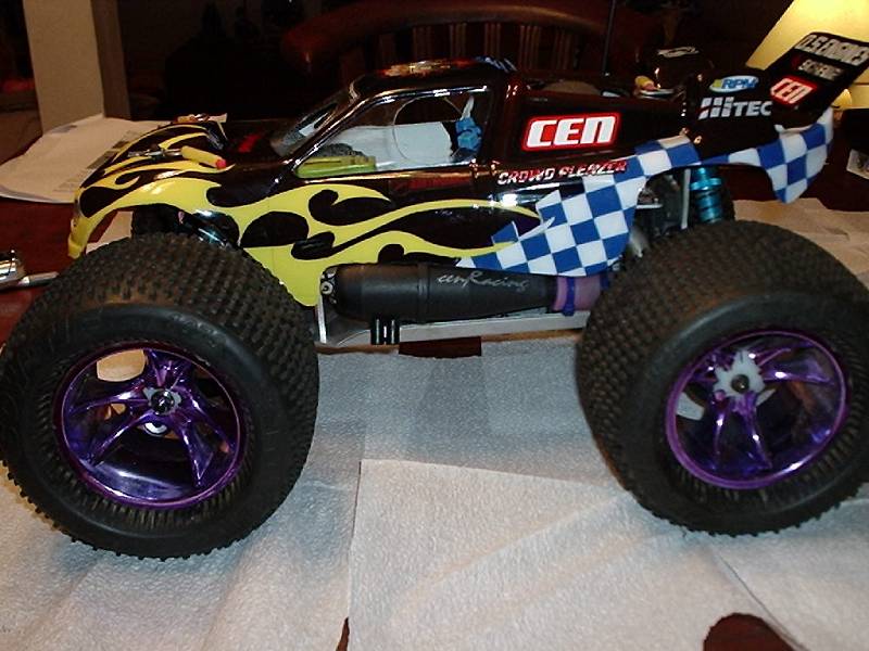

Hey PJ where did you get those slicks mate (pic), wouldnt get much grip on the sand...
I cut the top of the mount off and I'm using the bottom middle hole only....I'm going to stop by the local hobbytown and see if I can find something to use while I'm there.. I will try and take pics tonight.. I have to watch the 18month old for a bit tonight because the boss has to work late...... More to follow
finished the front
.. I was allowed to work on the truck last night so I did as much as I could... I even took pictures..... I will post when I can.. Everything worked great after I removed some of the shock mount... The drivetrain spins pretty well... not as loose as the cens, but it should free up a bit more over time.. I think its the bearings that are causing this.... I will be finishing up the truck tonight when I get home... maybe another hours work left and I will run (abuse) it tomorrow on my day off... Just a note on the bearings.. I ordered some acer ceramic bearings which haven't come in yet... These are cheapo duratrax from tower, they seemed a bit tight during test fitting... I have to admit I like the new design alot.. much more beefy than the cen ever was.. especially where the steering link connects... I don't think upgrade to rpm or even aluminum traxxas ones will be neceessary.
I most certainly will... If these hold up, I may have to seriously think about selling some of my extra trucks... I will do the jump test tomorrow... a 3 foot ramp and about 20mph= hell for the original cen drivetrain... Once this is sorted out, I have a race against my sons traxxas Electric 4-tec.... We just put in an 8 turn motor... have no idea how fast it will go.. guessing somewhere between 40-50 mph... or it may just take off like an airplane... its already fast with the 13 turn so this should be fun..
well.. finally finished the truck and tested it... ran great.... loosened up a good deal after a few minutes of running around... I have to mess with the steering a bit, thought I had it straight, so high speed runs were out of the question.. did get to test the durability when i crashed into a pine tree at about 20 mph... the only damage was I knocked the muffler off when the tire was pushed back into it... As expected, the drive shafts and suspension held up without a scratch.... No as promised... some pictures of the truck suring assembly and after...... Hope you like...
