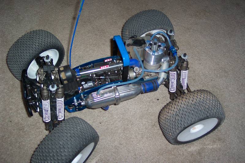

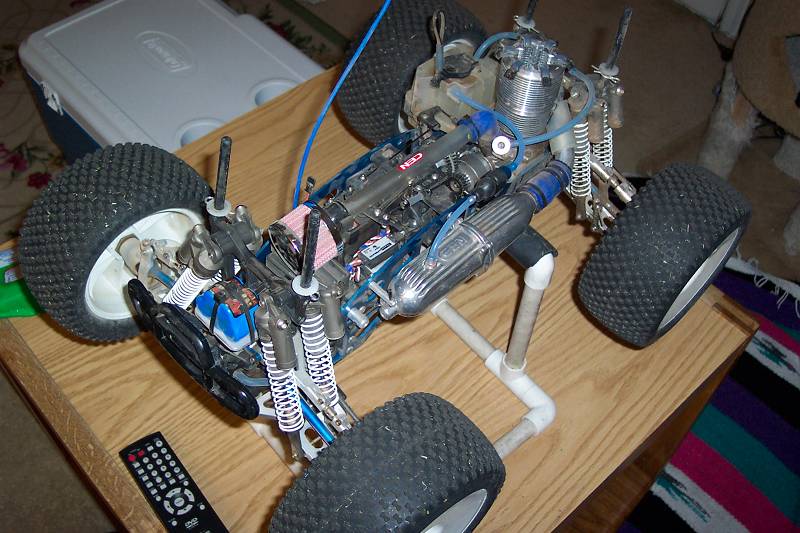

Not sure how big motorcycles are over there, but you can use motorcycle foam filter oil with no problems. With the dusty conditions you have, you may also want to switch to a 2 stage filter that has an outer prefilter, you buy a couple of prefilters and wash/oil them and your main filter will last a long time.
Adarsh, I live in the Sonoran Desert In Arizona. I Had A huge Problem with dust and my airfilter(cleaning it after every run) When I moved the air filter forward(right behind the front shock tower) I found myself forgetting to clean the airfilter, having to clean it every 6 -7 runs. Here are pictures of the simple mod I did that changed the way my truck got fresh air!
I also added a couple of shots of my swaybar installation on the front suspension. (3.5MM in The Front And 4MM In The Rear Seems To Work Very Well)
I hope this helps!!!Have Fun!!!!
