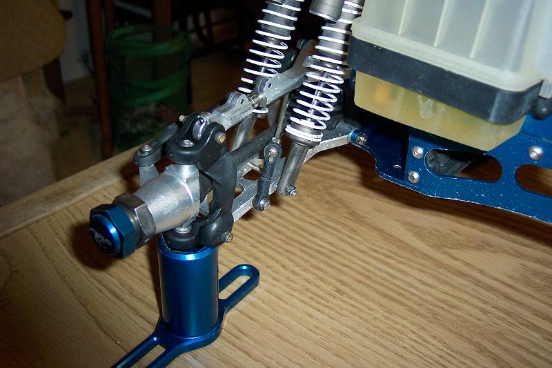

The sway bars are $20 + shipping that will get you both the front and rear sets
Let me know and I will make a set for you guys..I will post a pic of the Beta version which does not have the ends bent parallel to the hinge pins You will get the final version with the Parallel Bend

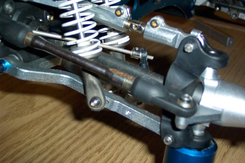

Here's the beta sway bars fellas:
This was just after a simple green bath so dont mind the red rash,,,it's minor
These are the betas, the final version I'm working on has a bend in the ends so the pivot balls axis are parallel.. I will have pics and a new thread for the final version,, so let me know whatcha think and should I make several sets in different thickness' for you guys..
