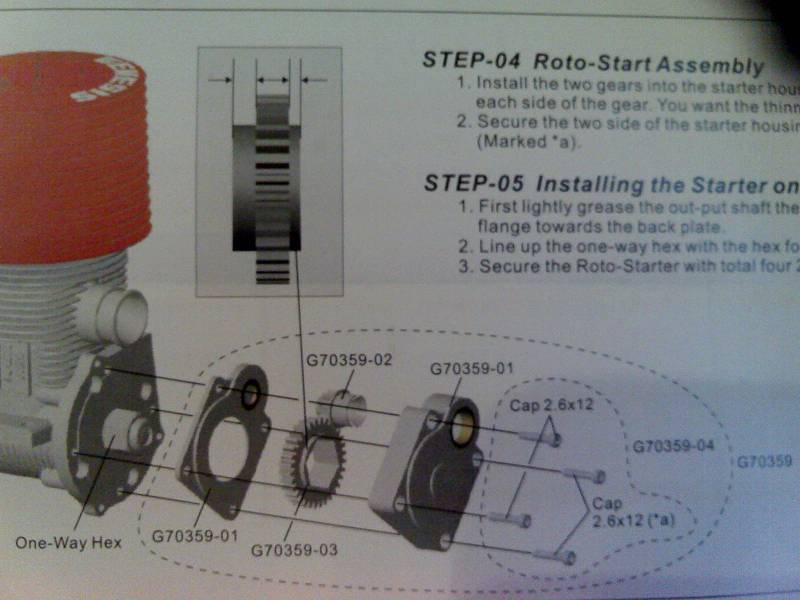

Just installed my roto start and just wanted to make sure it is correct???
one way bearing should be like the photo in intructions big side of bearing in towards engine????? narrow towards the oustside by the plate???
Big gear wider side out ,narrow side towards motor right?????
I just wanted to make sure before I put it all back together???
Also red locktite for the 4 engine screws......correct?
Thanks John

Hey amercnchopz34,
Ok if I'm reading you correctly;-
1-way bearing - correct.
Big gear - wrong, according to the instructions that came with mine the wider shoulder goes to the motor!
Small gear, obviously wider side away from the motor.
Not sure what what grade your Red Loctite is, but I would use (nut lock) 243 it is light blue in color, or (screw lock) 222 it is pink/purple in color.
If unsure about your particular application, you can click this link to the [link=http://www.loctite.com/int_henkel/loctite_us/index.cfm?&pageid=20&layout=2]Loctite Application Guide[/link]
Remember Loctite can be your friend, but if you use too much or the wrong grade for the application it will become your enemy!
Edit ;- You may have to remove a small portion of the ring on your exhaust header (where the 2 springs clip into) to allow the exhaust to fit correctly, without fowling on the new rotostart assembly. This is a common mod needed to allow correct assembly.

hey thanks for quick response!!!
I had all correctly ..........I did no t remove anything from my exaust header I put is all back together last night!!!
I put the header back spring was a pain to get back on ........but handled it and it tfits pretty snug so no mod needed!!!
thanks
John
