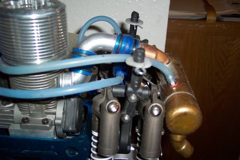

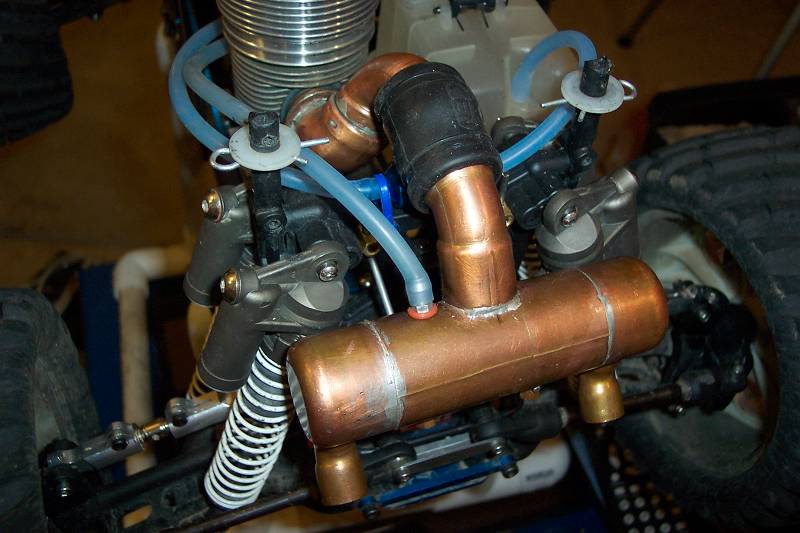

Boom stick. Sounds alot like quest I was on last summer. however I wanted to keep the current suspension and looked at the exhaust configuration all together. I found that you are VERY right! The NX76 is very capable of producing insane torque when the restrictive OEM header is replaced with something more free flowing. I also wanted to get the oil off of the right rear suspension. I had great success with the exhaust dumping out he back using a homemade twin tip triple chamber homemade piece out of common copper tubing. The truck sounded mean as hell and had killer torque, However the first header I made from copper tubing failed very quickly because I forget that the typical plumbing solder melted @ typical exhaust temps. I then tried to modify an existing header by cutting and rotating it to go ver the shock tower into my triple chamber muffler. WOW what a blast that was everything worked so well I wanted to have that header made larger inside diameter or better flow. But no takers were to be found and due to extreme stress on the silicone coupler and other projects it is now currently sitting on a shelf waiting for me to come with a way to make my own header like the copper header.
here are some pics as well maybe a couple in my gallery

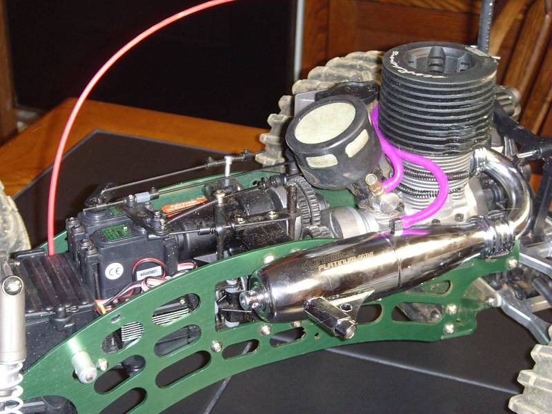

I started with this Dynamite combo http://www.dynamiterc.com/Products/D...rodID=DYNP5000
I picked it for two reasons, #1 It was cheap @ my LHS, and #2 the header would fit the space well. My intent is to get it rolling with a suspension that will function well, then try different pipe/header combos. Hopefully I get that tower order in this week or soon after so I can see what I can do to tighten up the rear.
Here is a pick with the exhaust just fitted on the truck. Before I took it out and tested it, I removed the other rear shock. (I ran with 2 shocks total on the rear (Both on the back side of the tower))

Yea thats the same pipe from the pix. I don't want to recommend it until I find a proper suspension mod in the rear to keep the front wheel on the ground. Its hard to test the power when half of it is in the air [:'(]
