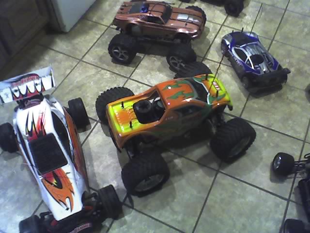

My gst 7.7 only lets me run it for 5 mins. at a time due to running hot, when i try to richin it a 1/8 of a turn it wont start. Could it be the fuel i'am using i'm using 30% trinity platium

IF you are running 30% nitro you should try to ad a head shim.

I thought CEN shipped the gst shimmed for 30% - at least thats what they claim

You could also be suffering from the half tank lean issue. There is a post on here with a couple of different fixes for this, the easiest one being the ofna fuel filter with the primer. I fixed this issue on my Nemesis by changing to a smaller tank. If you were using 20% and then went to 30% you need to reset the needles to factory and retune.
